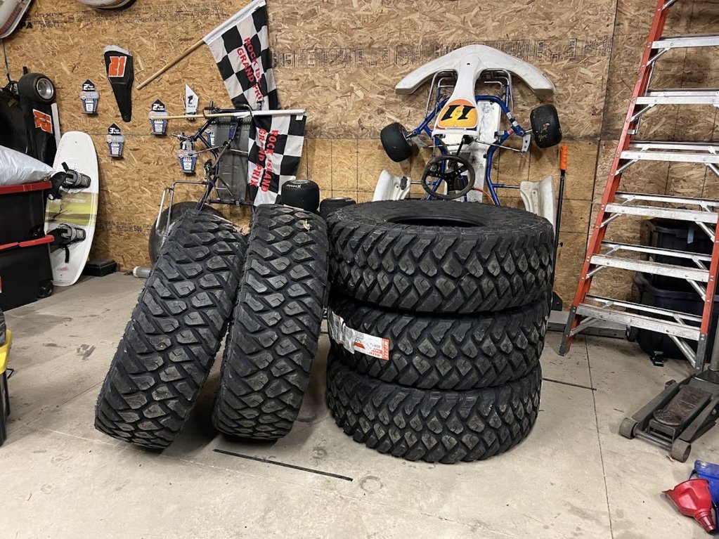

    Maxxis? What model?
    That truck will be a killer with 40s on it!

    We'll see how it holds together, I wheel with a ginger right foot so I'm hopeful that it will work pretty well until I'm ready to build the 609.
    They are Maxxis Razr's, I've got them in 37's on the first gen now and they work awesome so I didn't stray far. I considered the Mickey Baja Boss MT, but decided to stick to a tried and true tire. They run the Cooper casing that I don't like as much as the Maxxis casing.
