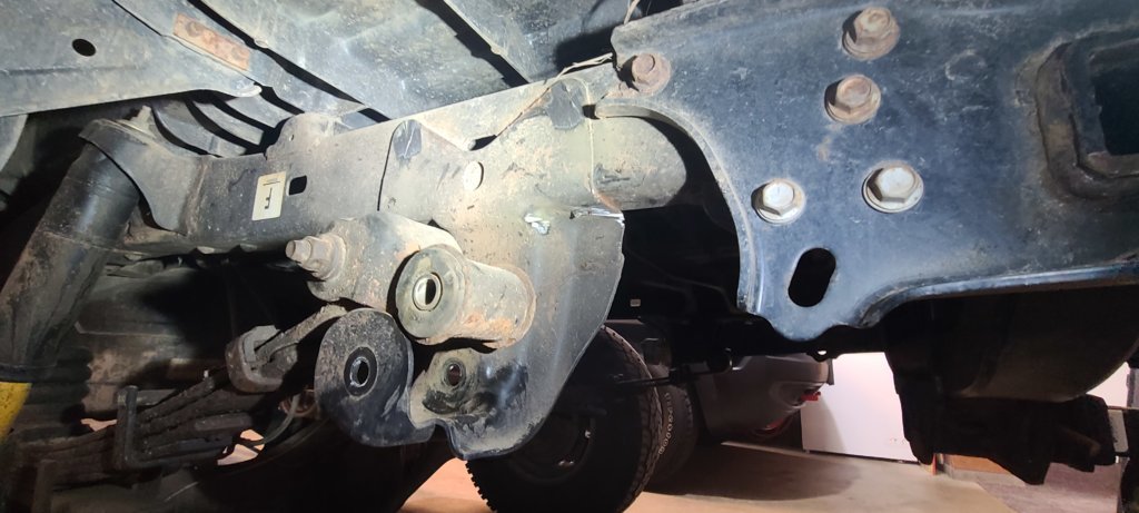

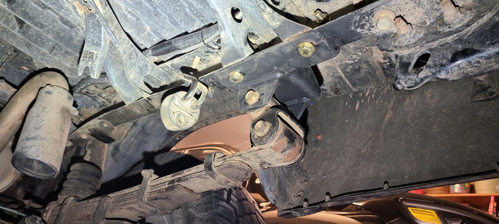

    Oooh...that shackle flip is niiice.
    Gave my factory rake back and now sitting at 2" all around.
    Softens up the back and absorbs the smaller bumps better.
    (that I thought was as good as it was going to get with the shocks).
    Up on the jack stands, the shock bottoms out before the brake line does.

    No way.
    Drilled them out.
    (It's a satchel)

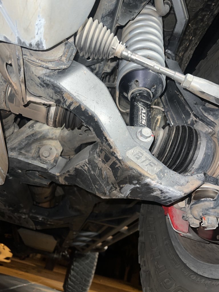

    I beat the hell out of my truck and I love them. I have zero concerns about them. I only sell/run products I’ve tested and run my self. :thumbsup:

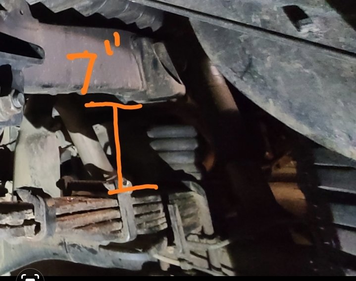

    On a serious note, you got enough bumpstop to catch the shock before it bottoms out?

    Threw a couple freshies on yesterday :D
    I have these on my site also

    I didn't physically check but the numbers say I have room.
    Correct me if I'm in the wrong...
    Shock expands to 24", compresses to 14".
    As the truck sits on the wheels, the shock measures 21"....meaning there's 7" left to compress.
    It is 7" exactly from the frame to the very bottom of the sumo spring.
    Sumo spring will max before shock does.
    At full droop you see the shock is bottomed and there's still a scoche of room on the brake lines.
