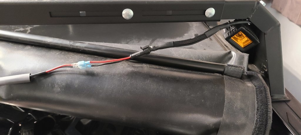

    In all the fussing around to get the winch mounted in the back I knocked a wire loose and my marker lights aren't working... bother!

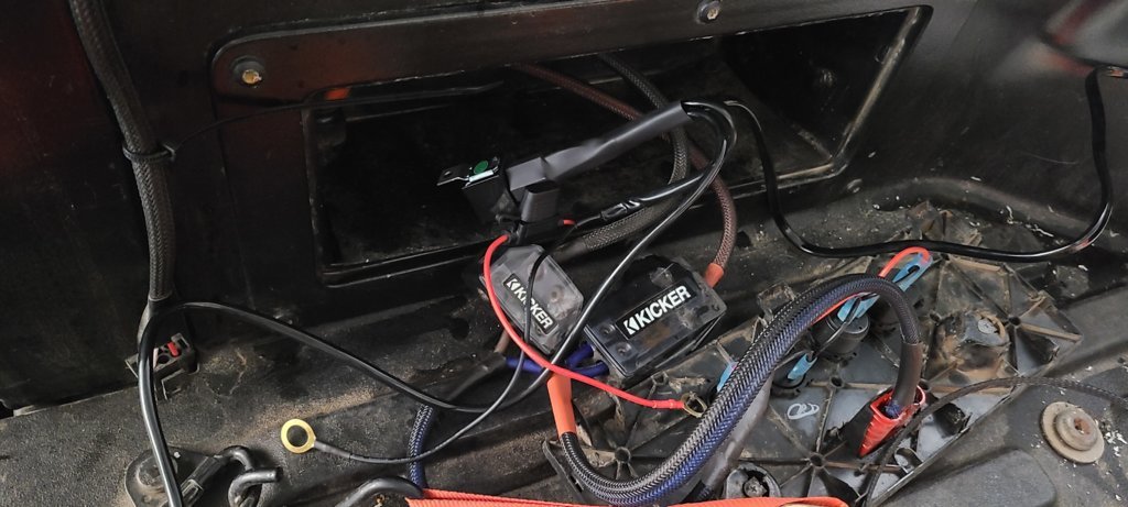

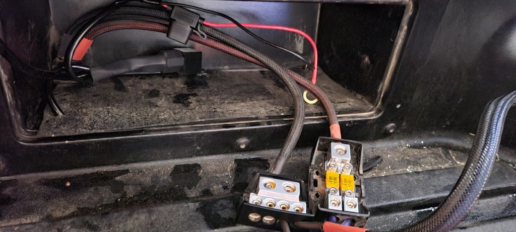

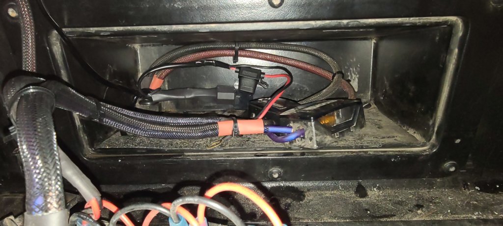

    Can you see me now?
    The cubby isn't as big a cluster flump as it looks in some of the other photos. I left slack for future endeavors and the outs are wired to the back of the cover.

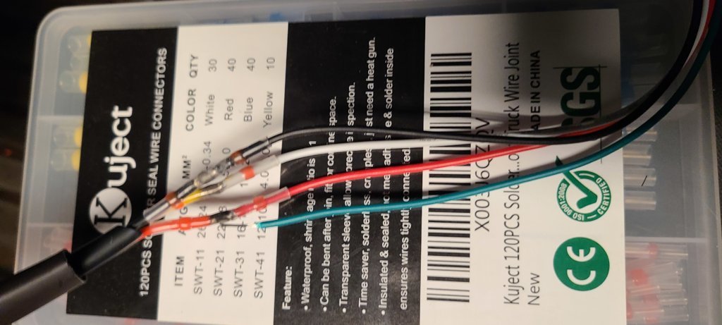

    ive done the majority of my wiring using those. they are awesome and have held up well going on 5+ years now

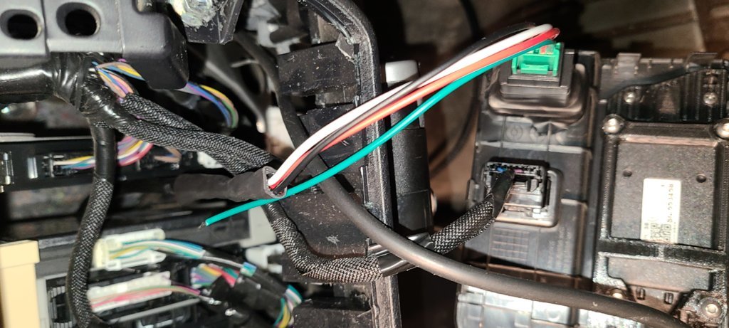

    Wire nuts can come undone on moving vehicles. They're fine for buildings and houses.
    I need to redo the switch. Light on switch draws constant power when hooked up.
    The other switch had 3 wires, this one has 4.

    Thought he was talking about the heat shrink soldering joints.

    Correct. I only use wire nuts in a house.
    anything in a vehicle is crimped or with the heat shrink solder connectors

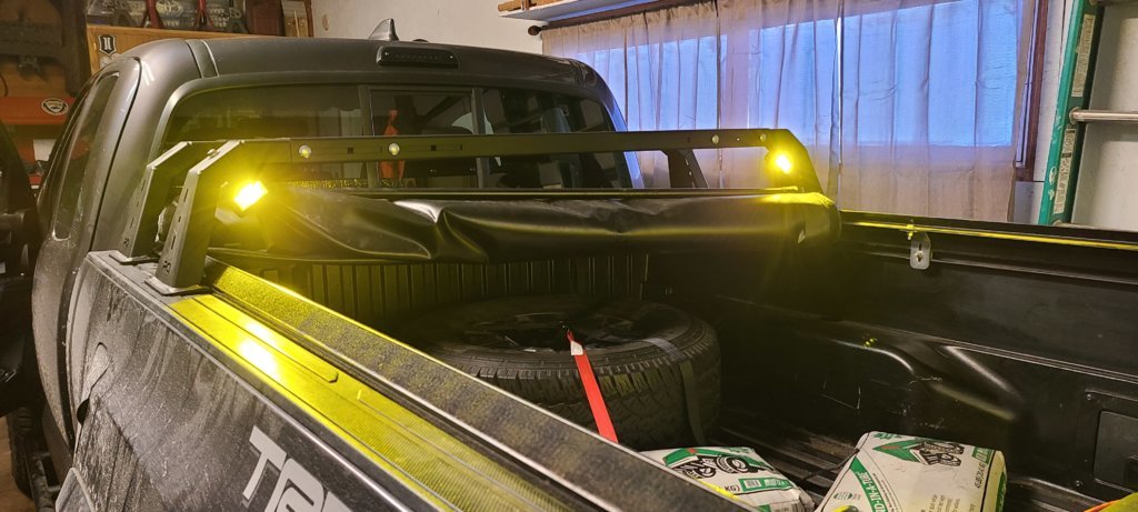

    Found my wiring gremlin and solved it until next time... Need to get some images at night and post them on the Diode Dynamics page cuz I got a lot of them.

    Found mine, too.
    Green from switch had to go to red from relay. Red from switch had to get jumped to white.
    Idk why they send switches setup for backlight to remain on 24/7.

    Oh there will be some mods all right
    Hard to wash the winders with this lol
