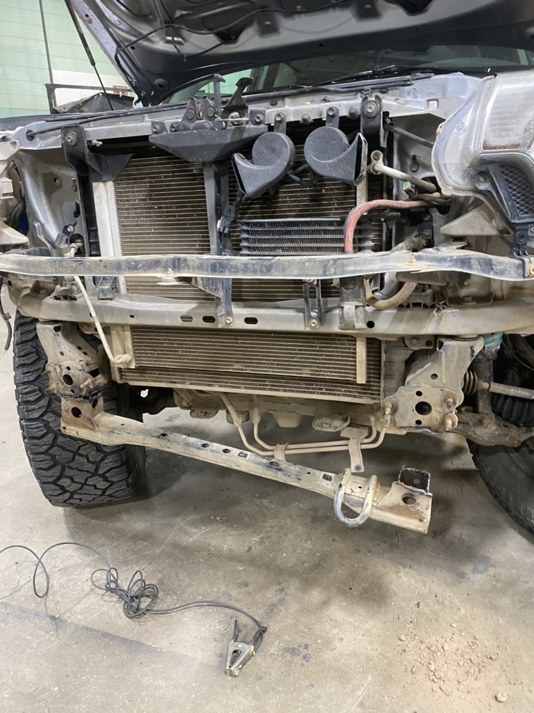

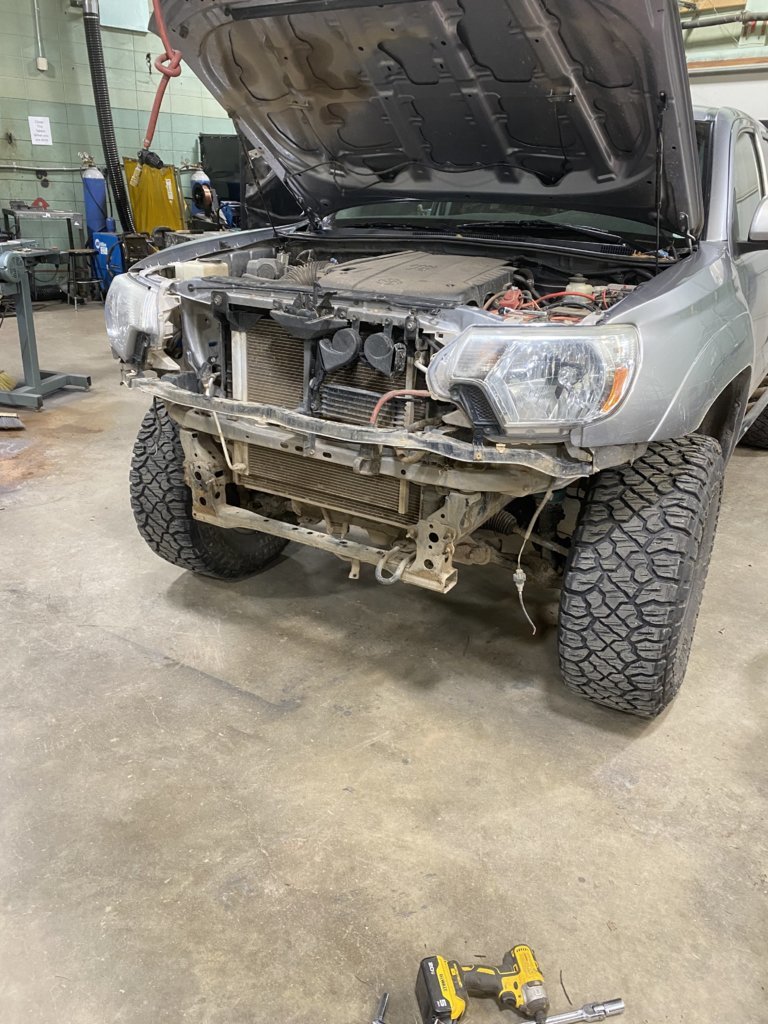

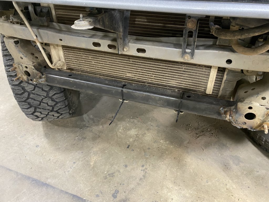

    Have to cut out a Toyota cross member and then weld in a new one higher up by the radiator

    This:
    No longer that:
    Raises the whole mess up about 6-7 inches. Good for clearance!!

    I know that the truck measurements are an approximation but CO's cross member replacement was short by 3/8 inch. Wasnt wanting to fill those gaps! Capped it with 1/8 and fit pretty good. Tomorrow it will get a thick coat of Hard On.
