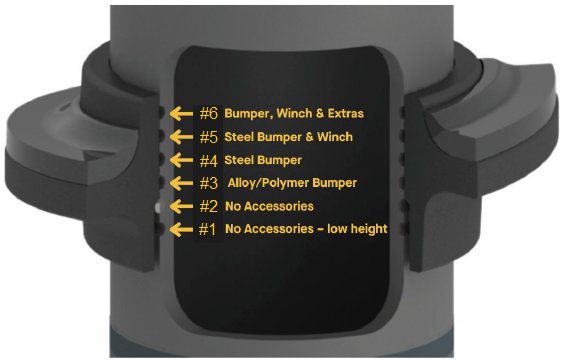

    Is there a setting for half steel bumper and winch?

    I don't like what I'm looking at, at all. Weight should be carried by the spring. Compensating for weight with preload sounds like the result of buying the wrong stuff.

    Descriptions aren't very good.
    I think it's all assuming to keep a 2" lift.
    It was a guess setting mine to #4 because I wanted 2" or even a little less was alright.
    No bumper. Receiver and occasional winch.
    (edit: They don't factor in skids but I added extra for them).

    yep. the proper spring for the weight and height is the best way to go.
    adjusting the collars is convenient if you are building over time but theres a trade off in ride quality.
