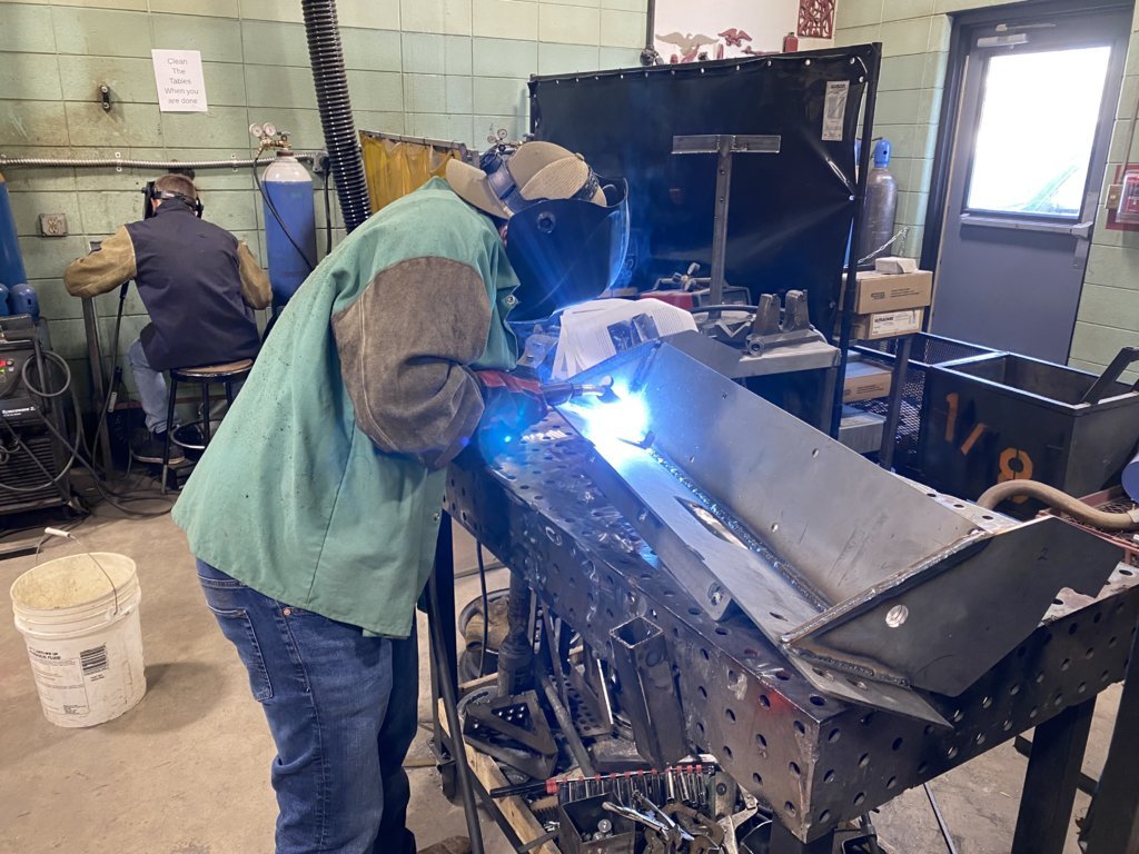

    Spent time today making sure all those fancy DD lights I bought are going to fit nicely in the new bumper. They do. The center section is all welded and the outer cover is tacked on.
    We started looking at fabricating the wings. Going to take some changes as the Mc Neil Fenders are considerably wider than stock. I will document the changes we make so you can follow along.
    I also found a new place to mount the temp thermometer thingy for my mirror up front. Now that the center is done I am going to look at what has to be fabricated to mount my silly expensive light bar up behind the grill. Should be a fun challenge! Hoping to be done welding before Ice Road Truckers weekend.

    Very cool... I have thought about it. We made some a few years ago that were bolted to the hub, but this is better because you can work on the wheels etc. One never knows what will come from the WHS metal shop...
