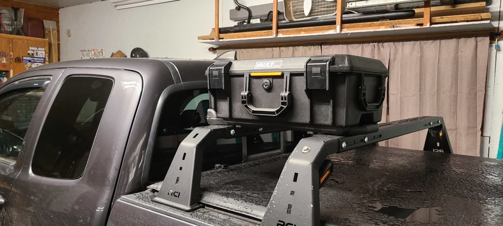

    Currently thinking of holding the Pelican vault to the bed bars by drilling 4 holes in the case and using some T-nuts.
    When case isn't being mounted, I can plug the holes with plastic screws.

    For my Pelican Vault on the inside I used m6 pan head machine screws with 1" fender washers, and a piece of bike tire tube under the washer for water proofing. Mine is on a roof rack with track nuts but if I were you I would use washers and a lock nut.

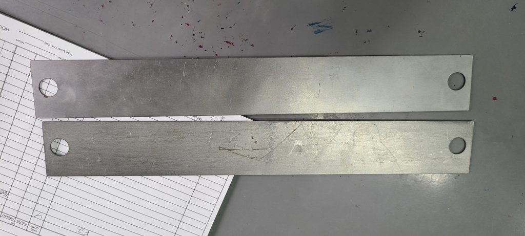

    I have a Apache (Harbor Freight) gun case for the roof rack. I have a 1inch aluminum strip that the bolts go through. I feel it helps spread the load if you have to come to fast stop.

    Thanks. I was looking for some 2nd opinions before I go drilling holes in a brand new case. :D
    I can get on board with bolts and washers. Already have those. Saw the T-nuts and thought it might work. I can see now how the bolts could loosen or be easier for thieves to remove...
    Thought the same about a metal strip inside so all the load isn't on the bolt holes......Great minds......

    3" lift? A.R.E cap 285/70/17 moto metal 955 17x9
    Those nuts you show are for wood,
    what you should do is use riv-nuts in the bed bar & run the bolts from inside the box that way its theft proof.

    The bed bars are slotted on top.
    After further review,
    Not sure how the riv nuts would attach well, without drilling new holes.
    I'd rather not put more holes in it.
