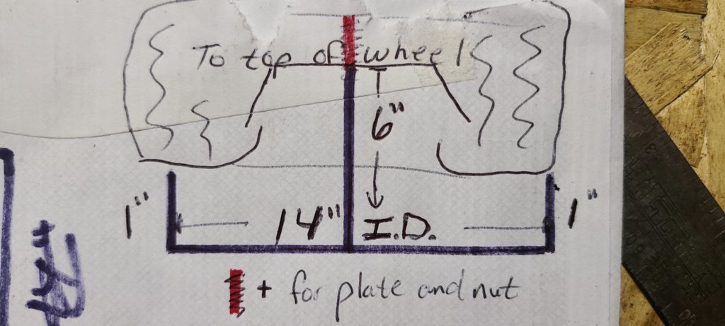

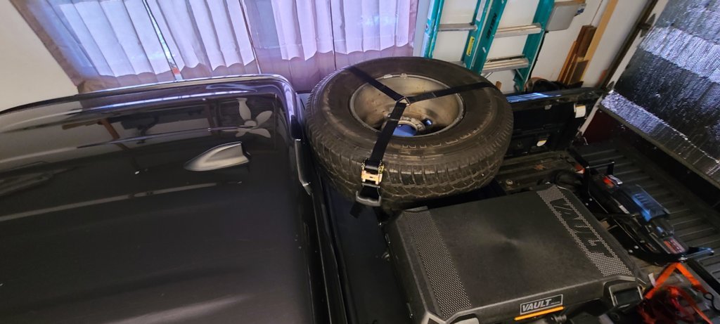

    Not to scale as that would make for about a 15" tire. :D
    I don't know how much to leave for threads or @OldSchlPunk cone? a couple inches? (Marked in red). It's 6" to the top of the wheel.
    Actual inside distance is 13-7/8 , but 14 will do.
  9. Jan 30, 2025 at 2:57 PM
    pearing
    pearing Well-Known Member
    Aug 4, 2018
    #261610
    5,215
    Wisconsin
    2015 SR5 quadcab
    So what are the 1" things on the side for? What does that lower plate attach to? Not seeing it in your picture. How wide? can I use lite 2" stra with reinforcement on the bottom for this?

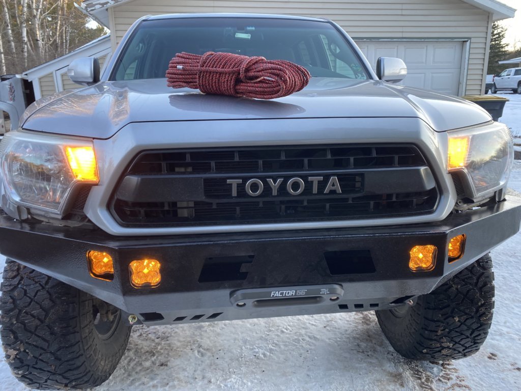

    Got my Fairlead on and the winch line came. It is way nicer than the HF line-but to be expected because it was twice as much. 85' of 3/8" joy. Winch is next... Can't see it but the cobbled together skidplate is on too!
    It will prevent the tire from sliding back and forth or twist.
    It won't attach to anything. Will Rely on the pressure of the cone/nut.
    Plenty of room for 2".

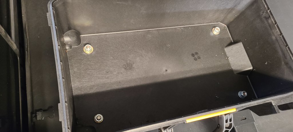

    I'm never away from my truck long enough for the time it would take someone to get this case off.
    All bolted down.

    In my opinion those washers are not big enough, you should put a metal strap that covers both holes.

    :D
    You are correct and nice catch.
    I almost forgot. :rofl:
    I did forget the strips at work, though. Scrap that was going into the recycling
    It's better to reuse than to recycle.

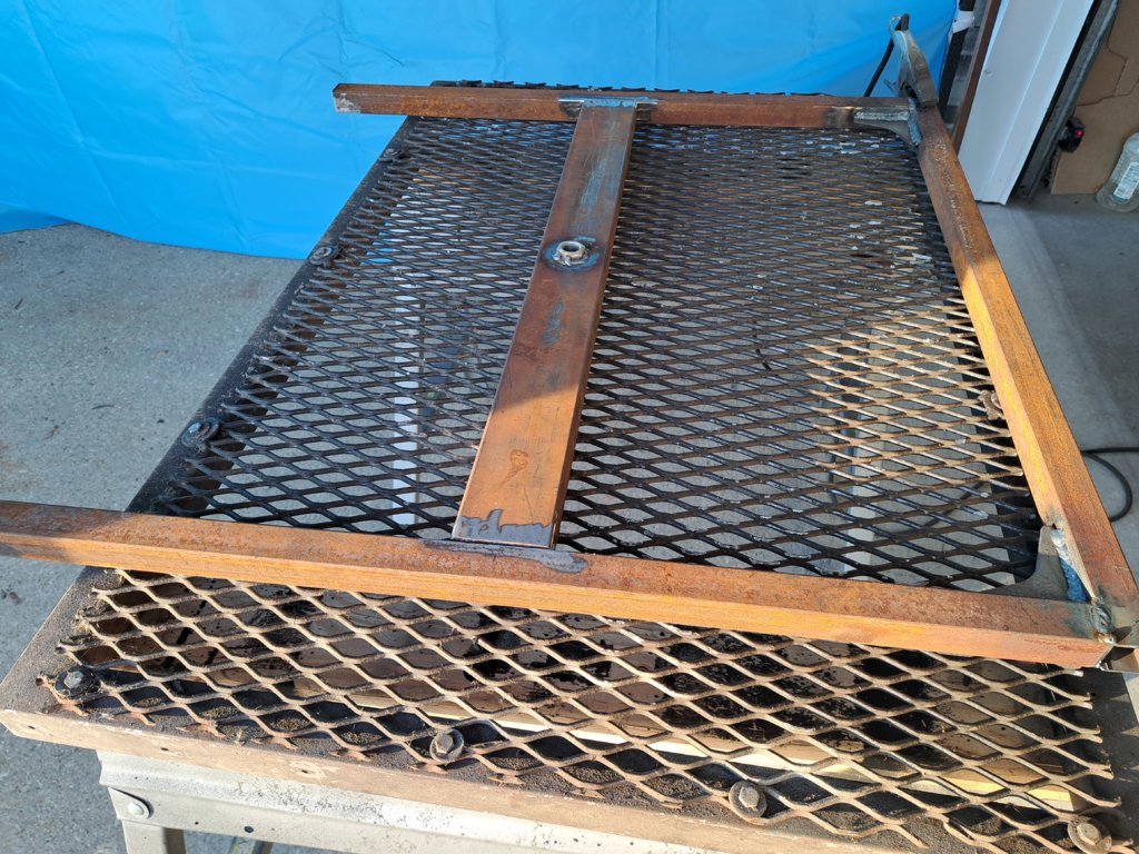

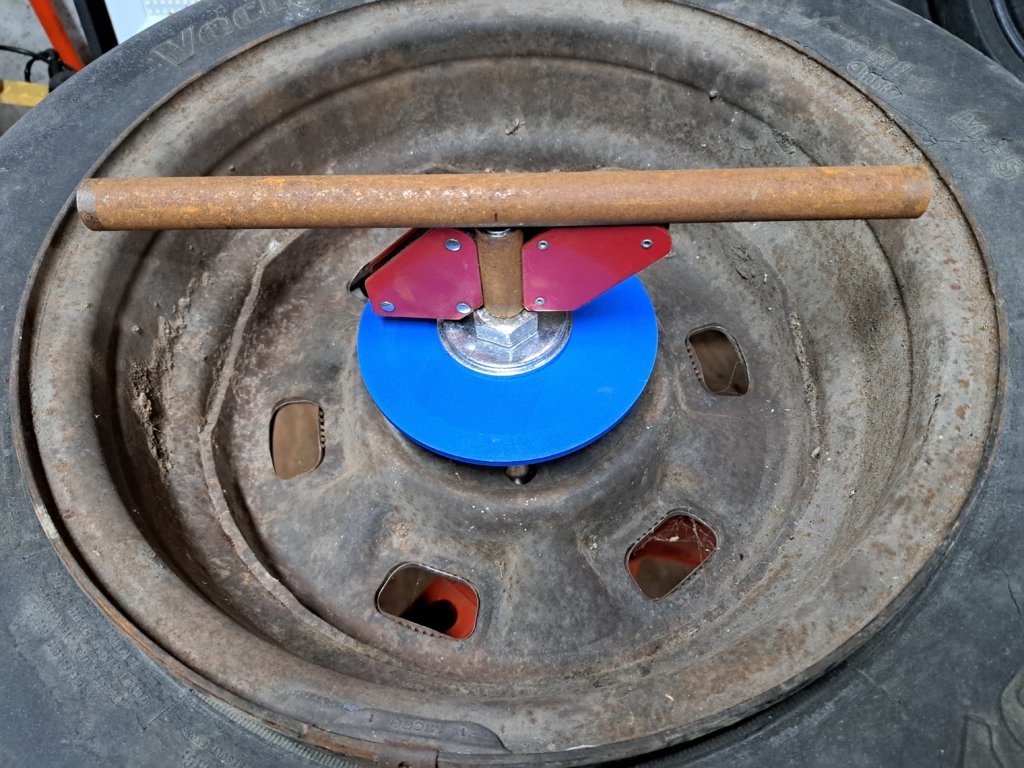

    The 'cone' is 40mm tall, approx half above and half below the inner face of the wheel. The hole is 30mm, I used a 7/8" bolt with a 'handle' welded to the bolt to tighten. The nut was welded to the frame.

    A true masterpiece. :bowdown:
    That would work with a nut on the bottom strip.
