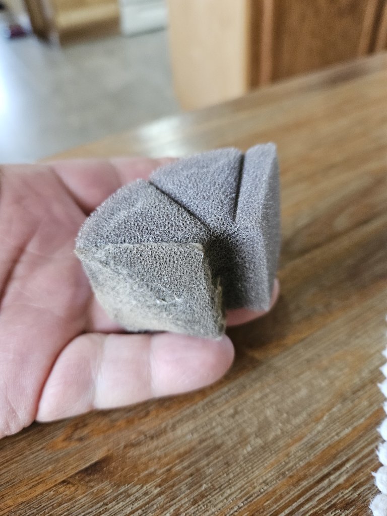

    My 4runner has a secondary air injection. As far as I understand, the factory foam filter inside it can fall apart with age as well, theoretically speaking.

    Yes, you are correct. At that's what I've read. It falling apart can lead to a costly repair. It's it takes maybe 10 minutes to replace the stock filter with the Uni filter.
    This is the stock filter.
    And again, if I can do it, anybody can do it. :cheers:

    The outside cover just snaps into place.
    There is 1 screw to remove, it's a #20 torx. Remove filter and remove round air inlet cover, it also snaps in place. Mount Uni filter to air inlet. Put it all back together. You should have 2 pieces leftover. The old filter and the air inlet cover.

    It’s nice to see a picture of it. It doesn’t seem to have degraded much given its age. Did it feel crumbly? Does it break apart or seem brittle if you pull on it?
    The sai is probably an “issue” because of the timing of when they can fail. It seems like it can last a long time, meaning that if it fails, it will be when the car is older. A big repair bill on an older car always seems to suck much more than the same bill on something newer.
    If your filter still feels flexible and non-degraded, I might hold off on mine till it gets older.

    It still felt good.
    With 140k miles it's just a bit of preventive maintenance. From my understanding toyota does not sell just the filter. I may be wrong on that.

    Good to know! I’ll probably wait till about that mileage too.
    I also remember hearing the same about the filter not available as a separate part.
