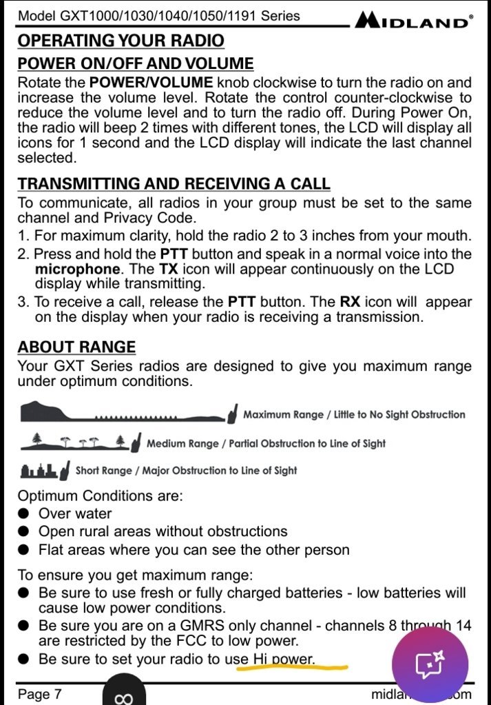

    Found the manual online.
    Down at the bottom....

    What's the max range?

    the setting is for transmit / broadcast power... its usually something like this depending on the radio
    low - .5w
    med - 5w
    high - 15w
    more broadcast power, more battery power required.
    more power will also get you more distance / obstruction penetration.

    With the exception of Channel 8-14.
    That are always low.?

    8-14 are frs channels so they are limited in power yes. thats the trade off for being unlicensed channels.

    That might have to do with transmitting and receiving a call.
    Post #46064 ^
    2-3" from face, in a normal voice.
    There's a 'whisper' function, on the Midland, that allows you to transmit quietly and still receives at normal volume.
