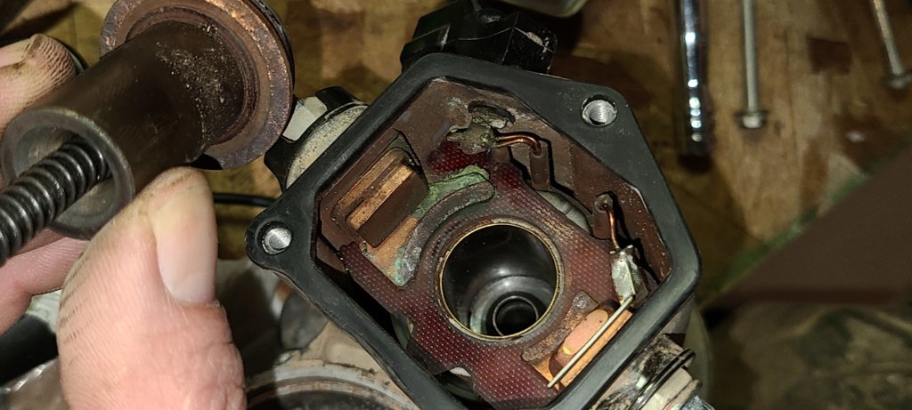

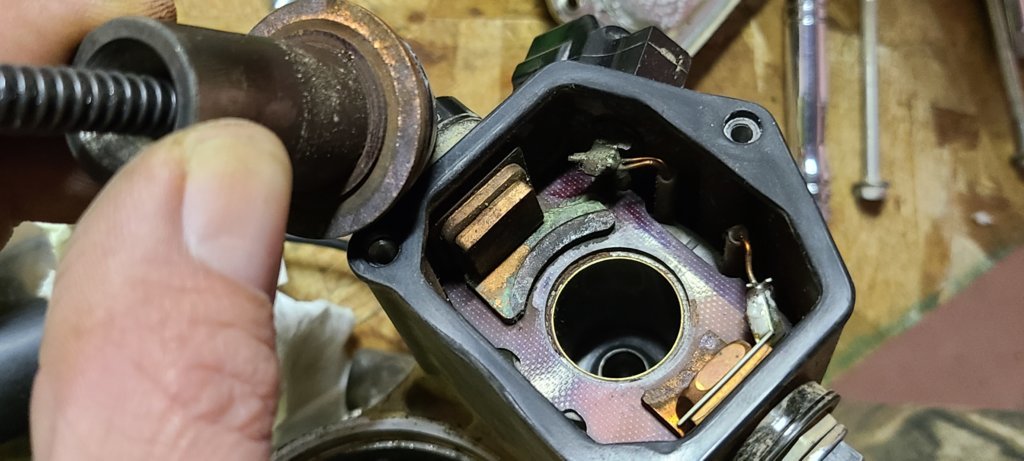

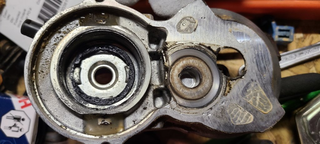

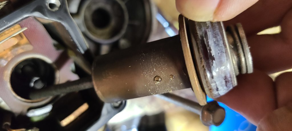

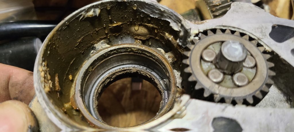

  11. May 3, 2025 at 9:07 AM
    bkhlrTaco's
    bkhlrTaco's “expletive deleted”
    Jun 16, 2023
    #426934
    6,076
    Brian
    Eau Claire, WI
    2016 OR AC MGM
    Dirty is not broken.
    There's still water in the solenoid and the gear box. Mud in the gear box, dirty plunger.
    Corrosion on the contacts.
    Clean and regrease, it'll be good to go.

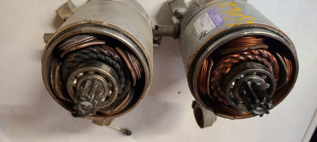

    2016 OR AC MGM
    Out of curiosity what flow accelerator are you using?
    I've since switched to the Pro, on the left.
    The other one looks like a big scoop for dirt and water.

    I have what came on the truck...assuming on the left.
  15. May 3, 2025 at 10:26 AM
    bkhlrTaco's
    Jun 16, 2023
    #426934
    6,076
    Brian
    Eau Claire, WI
    2016 OR AC MGM
    The one on the right was on my truck.
    I traded a T.W. member for one on the left.
    rockindoc75 and CygnusX191 like this.
