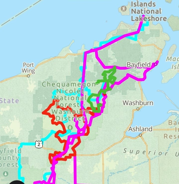

    Just about.....
    you've probably been on more...
    Green and Red routes were fall run.

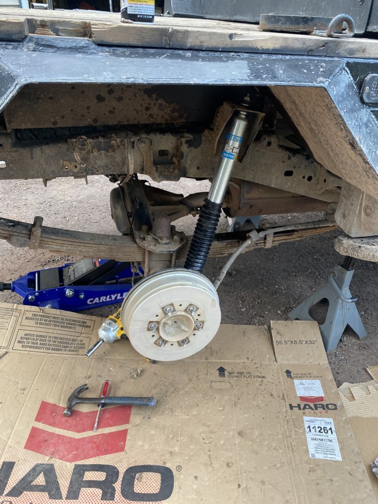

    Any of you hooligans had the rear axles out of a Tacoma rear end? Seems I have a seal weeping/leaking. It has been slowly getting worse, but now seems like it wants attention. Assuming missed debris from the Moab debacle caused this but who knows. Advice? Videos I should watch? TIA

    I had the passenger side out of my 1st gen to replace a seal.
    Advice?
    It isn't that bad.
    Buy 2 seals incase you warp the 1st one.
    They need to go in straight and flush. Any kink will cause it to leak again.

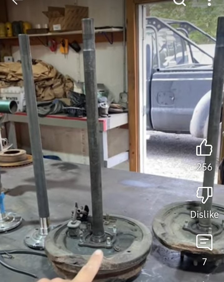

    It's been awhile so I don't really remember how it came apart.
    I think once you remove brake line, you remove the 4 nuts on the back side of the hub and it should slide right out.
    like so...

    That is kinda what it looks like. I will watch a video as I am sure there are several. Thanks for that!
