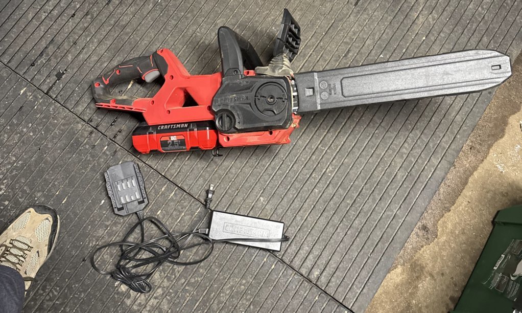

    Was offered dibs on a Craftsman battery chainsaw several times.
    Not a Craftsman guy other than some sockets and box ends I've aquired. Also not keen on another battery charger to plug in.
    $150 is the 'asking' price. Out of boredom tonight I looked into it.
    It's the Craftsman v60 2.5ah 16"
    From the little I've gathered, Craftsman doesn't make that saw, or battery, anymore. I'm thinking the saw is pretty much junk as soon as the battery dies.
    Edit: It does come with the charger, so it's got that going for it.76923437272__9CAC350A-920D-494A-BECC-C0C7AD0A764F.jpg

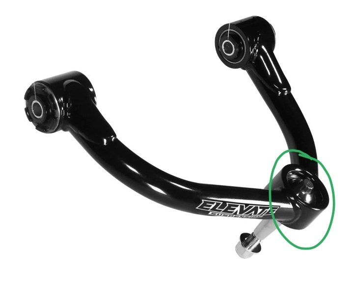

    Are uniballs worth the extra maintenance.
    I was looking at trying Elevate ball joint uca's.
    Found their uniball version on ebay for less.
    https://ebay.us/m/P4levQ

  4. May 18, 2025 at 5:06 AM
    pearing
    pearing Well-Known Member
    Aug 4, 2018
    #261610
    5,215
    Wisconsin
    2015 SR5 quadcab
    They don't break. But, they are a PIA because you have to lube them every time it rains. Last set only lasted about 15 months-but I wasn't taking care of them. Mud and water don't do them well. See how long these guys last with constant oiling.
  5. May 18, 2025 at 5:29 AM
    bkhlrTaco's
    bkhlrTaco's “expletive deleted”
    Jun 16, 2023
    #426934
    6,091
    Brian
    Eau Claire, WI
    2016 OR AC MGM
    Come to find out.....nothing on these trucks take a liking to mud and water. lol
    While I was changing oil yesterday, I took a brush and rag and cleaned all the shit from around all and any boots.
    A greasable ball joint would certainly make things simpler.
    Looking at the elevate uca design and wondering.....why not fill the entire uniball housing to the top with grease. To keep dirt from getting on it.
    That whole 'cup'. Easier to dig grease out than dirt.

  6. May 18, 2025 at 6:11 AM
    pearing
    Aug 4, 2018
    #261610
    5,215
    Wisconsin
    2015 SR5 quadcab
    Good idea. Still get shit from the bottom, and much harder to get the oil in to lubricate-have to make a path through the grease to let it in. These need oil to lubricate the innerds...
  7. May 18, 2025 at 8:30 AM
    Shellshock
    Nov 21, 2015
    #170338
    23,480
    Iowa
    2.5 ah is enough power for like 3 minutes of cutting
    the m18 is $100 off currently which is a much better buy
    https://www.homedepot.com/p/Milwauk...-Battery-Chainsaw-Tool-Only-2727-20/307750956

    From what I understand, no. I personally wouldn't use them on a daily driven vehicle.
    I'll be happy to hear why I'm wrong, though, if I am.
    I have 100K miles on ball joint UCA's, and so far they're holding up. Granted, I don't drive through quite as much mud water as some members. :D
    This reminds me: I should probably grease them sometime. :oops:

    Did you buy these? Do you like them?
    4wheelparts is having a 10% off sale with code flash.
    Elevate's ball joint uca's (1114) are $540 and the caps (1190BK) are $45.
    Seems like a solid option for ball joint uca's for under $600. :notsure:
  15. May 18, 2025 at 3:12 PM
    bkhlrTaco's
    Jun 16, 2023
    #426934
    6,091
    Brian
    Eau Claire, WI
    2016 OR AC MGM
    This ^ is what has me looking at them. When comparing to Dirt King.
    That and they boast about the quiet bushings.
    I have not hit the buy button, yet.
    Last night I found their uniball version on ebay for $550.
    Still contemplating whether I want the extra maintenance or not.
    That's a good deal on 4wheel parts. I always see the ball joint uca's around 600

  16. May 18, 2025 at 3:22 PM
    sparkystaco
    sparkystaco Well-Known Member
    Jan 26, 2010
    #30122
    5,918
    Sparky
    SE Wi
    06 4x4 dc trd ofrd
    3" lift? A.R.E cap 285/70/17 moto metal 955 17x9
    Mine lasted to 170k and I changed uppers cause of rust not bad joints.
    I did have one lower that was getting loose.
  17. May 18, 2025 at 5:16 PM
    pearing
    Aug 4, 2018
    #261610
    5,215
    Wisconsin
    2015 SR5 quadcab
    I probably wouldn't recommend a uni ball on a daily driver. Have to lube them every time you buy gas. Now that I know, I just do it. I also made the tools to change the balls and that only takes an hour or so. Amazon uni balls are about 50 ish each which is WAY better than what Total Chaos and some of the others wants for theirs. So far the cheap ones are holding up. They don't seem to last as long, but now that I understand what I bought I am in.
  18. May 18, 2025 at 5:58 PM
    CygnusX191
    CygnusX191 Gangster of Boats
    Nov 29, 2016
    #203575
    21,093
    Timm
    St. Louis, MO
    So. Many. Stickers.
    For a guy as handy as you they seem alright.

  20. May 19, 2025 at 8:22 AM
    OldSchlPunk
    OldSchlPunk A legend in my own mind!
    Feb 13, 2022
    #390091
    5,619
    Rich
    East Central Wisco
    '17 OffRoad Silver Sky Metallic
    Small lift, slightly oversized tires, well...
    I think I may be late to the party...Whiteline have a similar product $100 cheaper and they have free shipping and 10% off your first order. https://whitelineperformance.com/collections/all/products/kta247-control-arm-upper-arm
    Those are what are sitting in my garage waiting to go on when I re-do my lowers. They look like good quality parts and came recommended.
