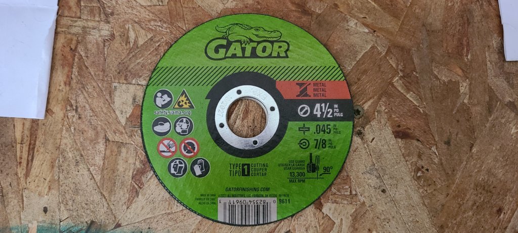

    Here you go @Taco-Grinder . I grabbed a couple of these Gator cutting wheels.
    (Never tried them before).....
    next time I see ya remind me. <----:rofl:
    Compliments of @rockindoc75 :)... because I shredded yours and mine. :oops:

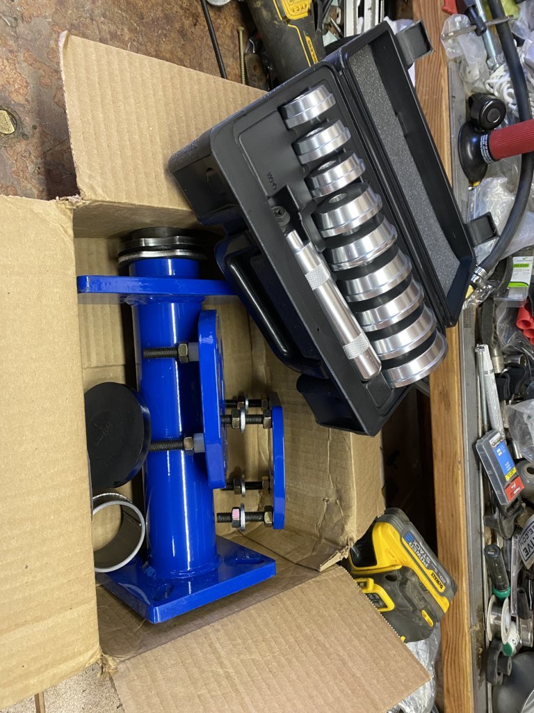

    Got some tools for my next truck project: the blue thing is the rear axle bearing puller. The other is for pressing the new axle seals in. Seems somebody said it wasn’t a big job but I am guessing most of a day to make this happen. Might not have time until after my Montana trip

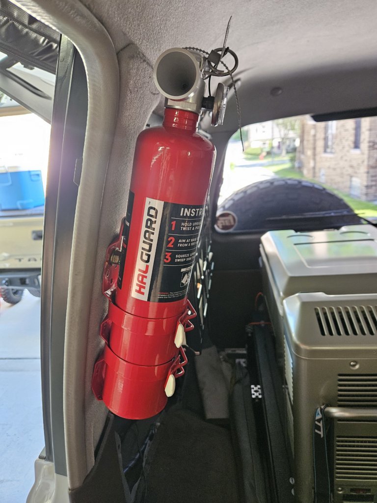

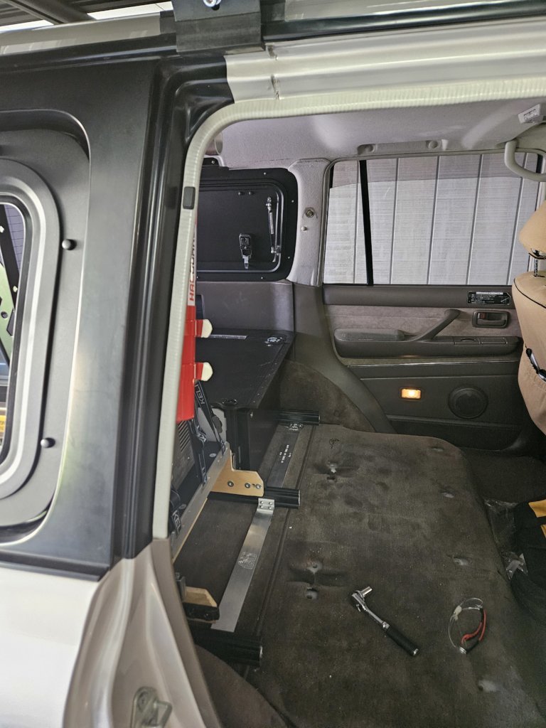

    I was inspired from yesterday and came up with a simple but cool mod.
    Since I'm not using the rear seats of the cruiser, I wanted to take advantage of the 14mm seatbelt bolt in the C pillar. I had leftover quick release brackets from my H3R fire extinguisher, and it's just the ticket. Fast to get to and tucked away.
    Cheers :cheers:

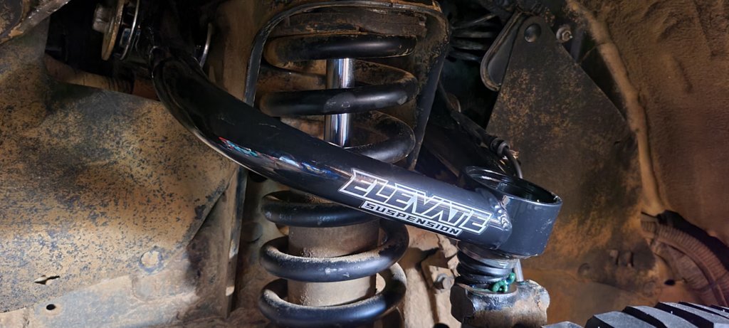

    Sucker for punishment.
    Dan gave me a quick runover of what to do.
    I need to get it done while it's still fresh in my noggin'. :cool:

    Halon?

    Is there anything besides bending for clearance of the bolt?
  19. May 25, 2025 at 5:27 PM
    bkhlrTaco's
    bkhlrTaco's “expletive deleted”
    Jun 16, 2023
    #426934
    6,090
    Brian
    Eau Claire, WI
    2016 OR AC MGM
    Besides bending the inner fender a little, there's wire clusters on both sides that are in the way.
    Took a little finangling with the bolt and wiggling the UCA around, to get it out past the wires.
    Other than that it wasn't bad.
    I didn't need to bend or cut any bolts.
    Edit: I left the tires on. Loosened all the bolts then sprayed the uca bolt with weiner schleider.
    Lifted the truck at frame enough to tap the ball joint loose then worked on getting the uca bolt out.
    *back to working by ourselves. lol
    I felt I had good control of getting the new ball joint positioned, on the spindle, with the tires lightly touching the ground.
