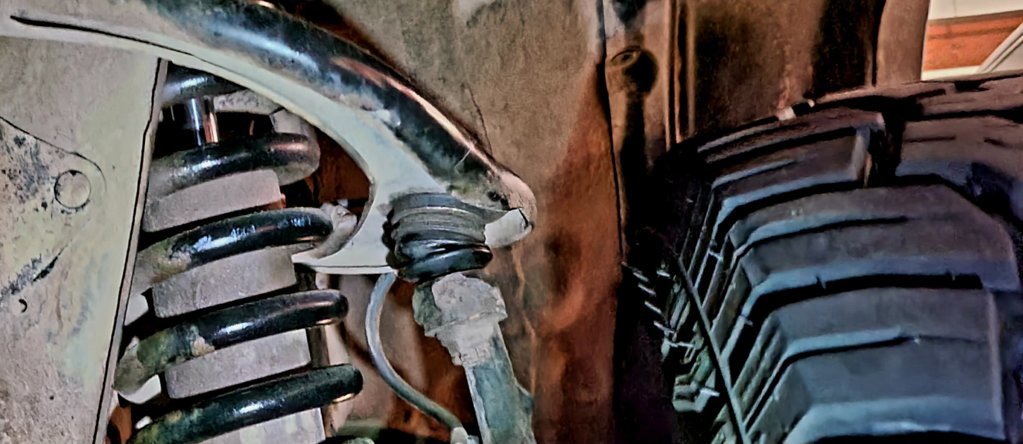

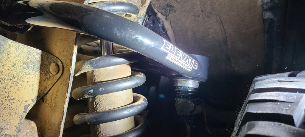

    Pertaining to UCA's: When you look at how much droop stock uca's have vs. aftermarket.
    The aftermarket look like they allow the shock to do its job better and the uca can swing freely up and down. (laying more flat)
    The angle of the stock uca on lifted trucks, is enough to send the impact more into the upper shock mount via uca.
    One man's unprofessional opinion.

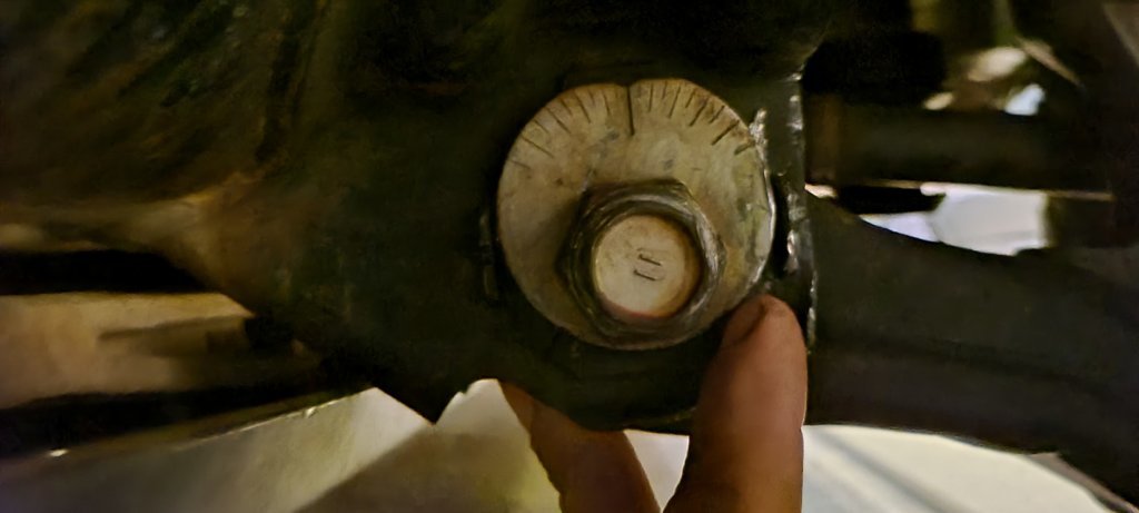

    Not sure when it happened but this tab was bent and the cam bolt was shifted over. This is the arm with the seized cams. (left/front)
    20250526_105445.jpgI was able to fully loosen the bolt and -0- it out.
