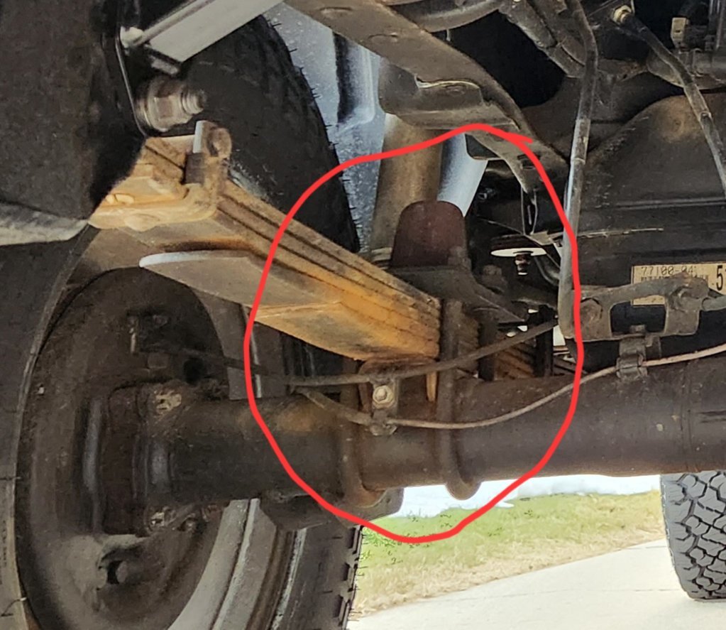

    Can someone explain the benefits of the u-bolt flip to me like I'm a 6 year old? I've never looked into it myself. I replaced my u-bolts when I added shims, but never looked into if/why I should flip.
  11. Jun 3, 2025 at 7:58 AM
    BEAR_KNIFE_FIGHT
    BEAR_KNIFE_FIGHT bearly famous
    May 21, 2016
    #187524
    2,616
    Alex
    Minnesota
    2016 TRD OR 4X4 DCSB Slowsand, 2017 WRX WRB
    The plate that holds the u-bolts [that gets tightened with the bolt] tight to the axle and leaf pack hangs below the axle by a decent bit. flipping it up allows you to just have the u-bolt sitting below the axle, and the plate is on top. free clearance (yay), flat strike plate for bump stops (also yay), keeps the u-bolts from dragging/bending/etc.
  12. Jun 3, 2025 at 8:05 AM
    rubbersidedown
    rubbersidedown Well known voider of warranties
    Jun 22, 2022
    #399907
    1,715
    Dean
    WI
    2020 Tacoma TRD OR Long Boi Voodoo Blue
    Gotcha. So clearance gained (I'm all about that) and no risk of messing up those threads underneath too. I may have to look into this. Open to suggestions for tried and true kits.

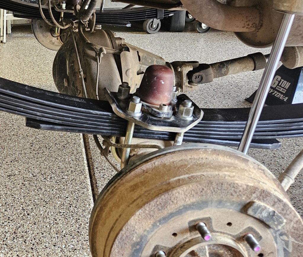

    I'm partial to the Archive Garage U-bolt flip with the option 3 bump stops https://archivegarage.com/products/...t-gen-tundra-2000-2006?variant=42096145661999
    The top plates are heavy duty. I had a different flip kit before the Archive and the top plates actually bent when I went to retorque the bolts...
    Pic
