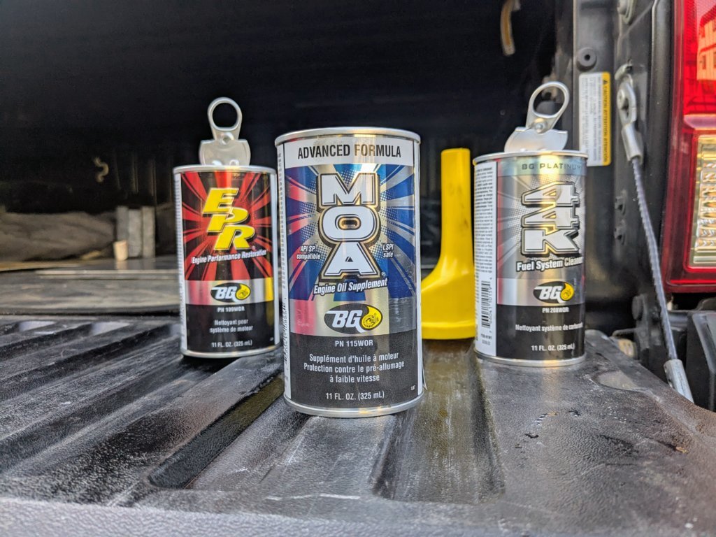

    Is it possible you forgot to top it off after the last change? When you first turn it over the filter will suck some of that brand new oil in and "drop" your level on the stick a bit.
    Do you have a catch can? Blowby is pretty prevalent on these things, esp if you don't have the fake attkinson cycle tuned out
    Also
    Timing cover seep/leak could be a culprit
    Highly recommend doing a BG suite on your next oil change as well

    Measured the oil that was drained and it came out to just over 5 quarts, with some still left in the filter. No catch can, the internet always seems to be split 50/50 on effectiveness - worth considering, for sure.
    I haven't heard of that BG brand, but I'll definitely check it out! Thank you for the tips dude

    And BG definitely isn't snake oil. (Part of my formula for success though)
