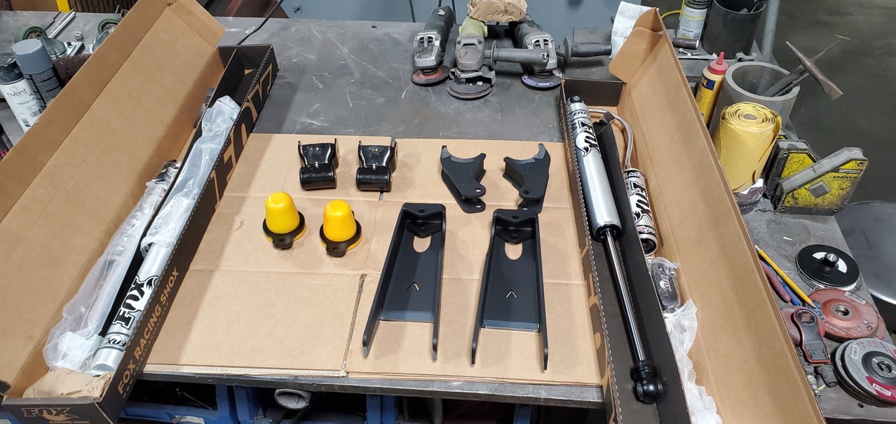

    No turning back now. Archive Garage trail series shock relocation kit and Fox 12" 2.0 shocks with adjusters going in this week.
    More pics as I go along.

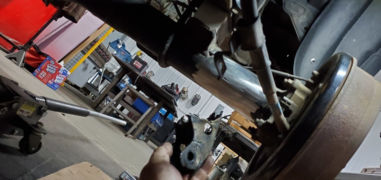

    Getting to be too good of friends with the grinder lol

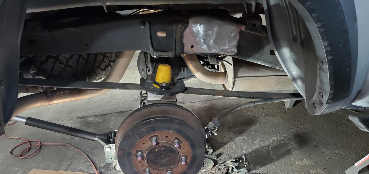

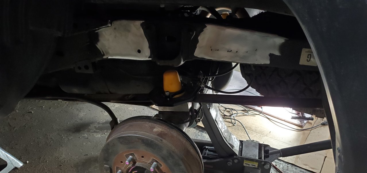

    Stock shock mounts on both sides are gone! That was not fun lol. Time to clean up the work area for welding tomorrow.

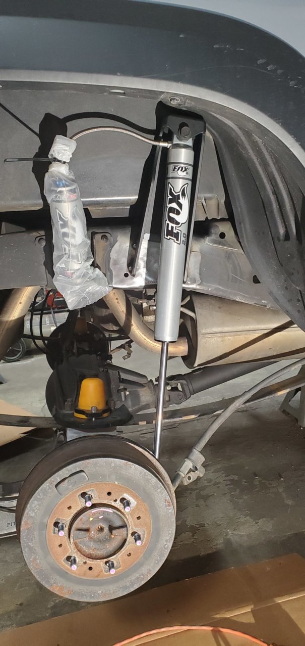

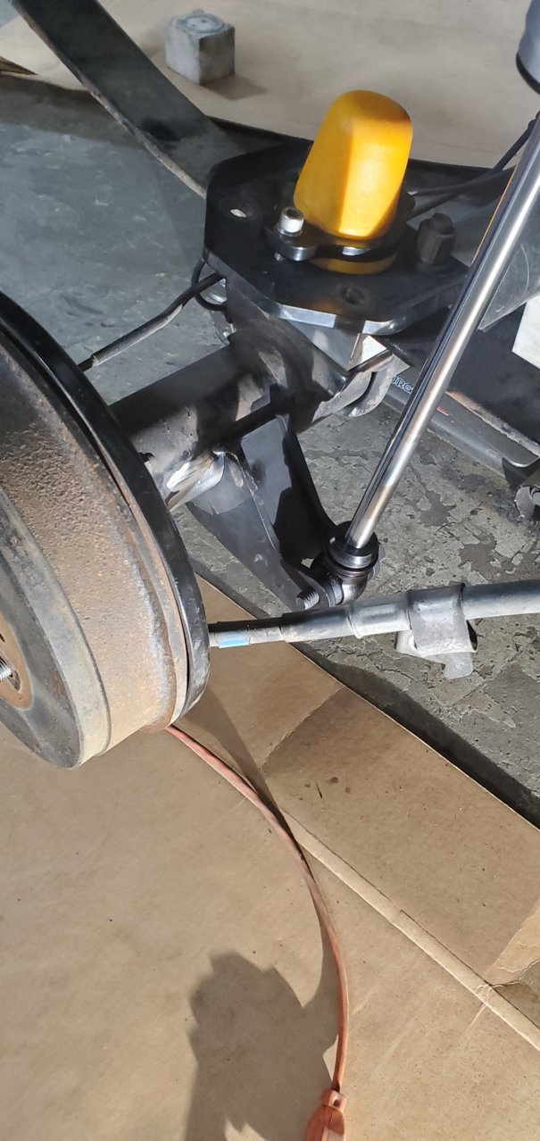

    New shock mounts tacked on both sides and suspension cycled for travel. I'm going to have to cut the tacks on lower shock mounts and rotate them up more, too much shock shaft exposed at max bump height.

    Painted, fluid film on new parts, and done!! Parking lot was too icey to use the forklift for a flex test :(
