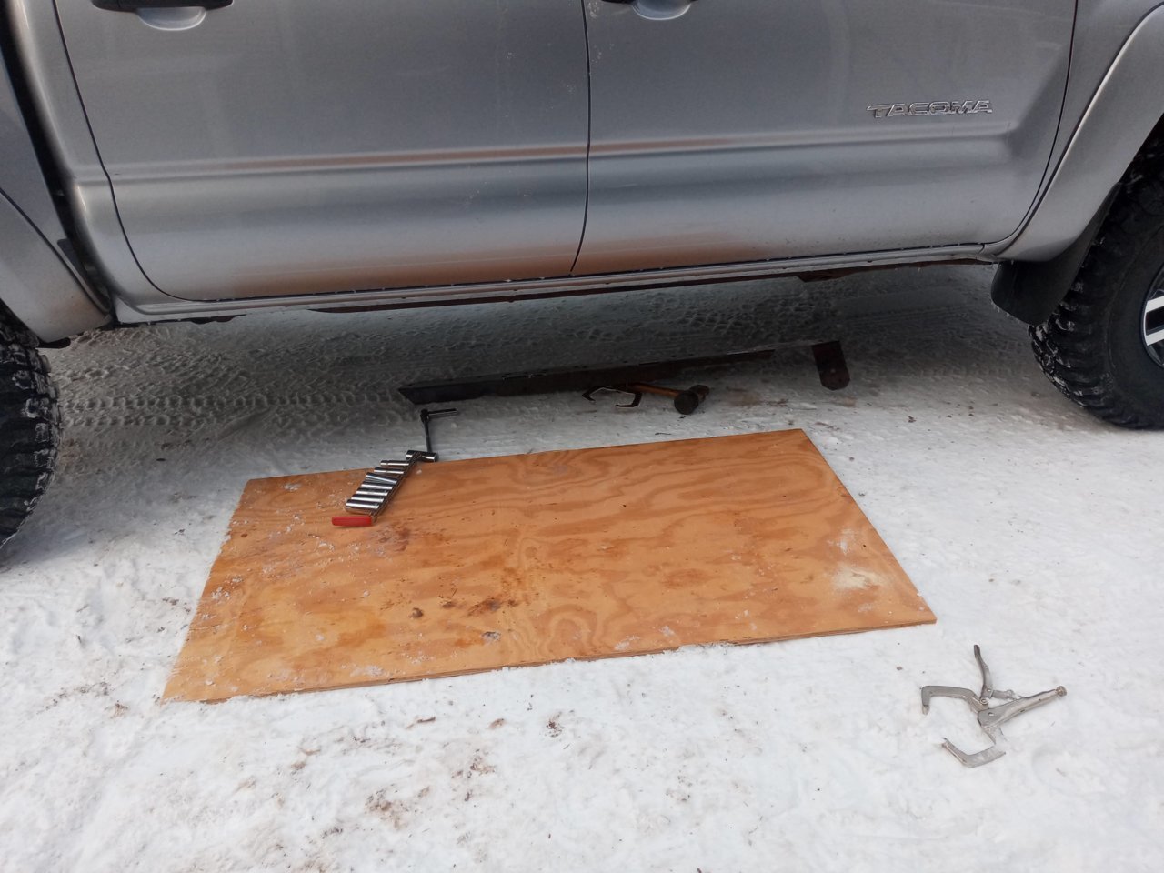

    Okay-Wisconsin crew, I need some help.
    Was laying out in the snow getting started on my slider project. I am building these with the first tube out from the frame (and plate that bolts on) out of 3/16" 2" square tubing. Seems to be pretty typical. They will come out with four supports, 1"" above the bottom of the frame (so up the frame one inch.) This leaves me with 11/16" between the pinch weld and the top of the tube (the tube will extend out past the pinch weld by 1/4".) The cab has bushings and flexes, will that 11/16 be enough space that the cab doesn't hit the tube??? Thanks in advance

    Going out to measure
    Stand by
    3/4 inch clearance with no problems here

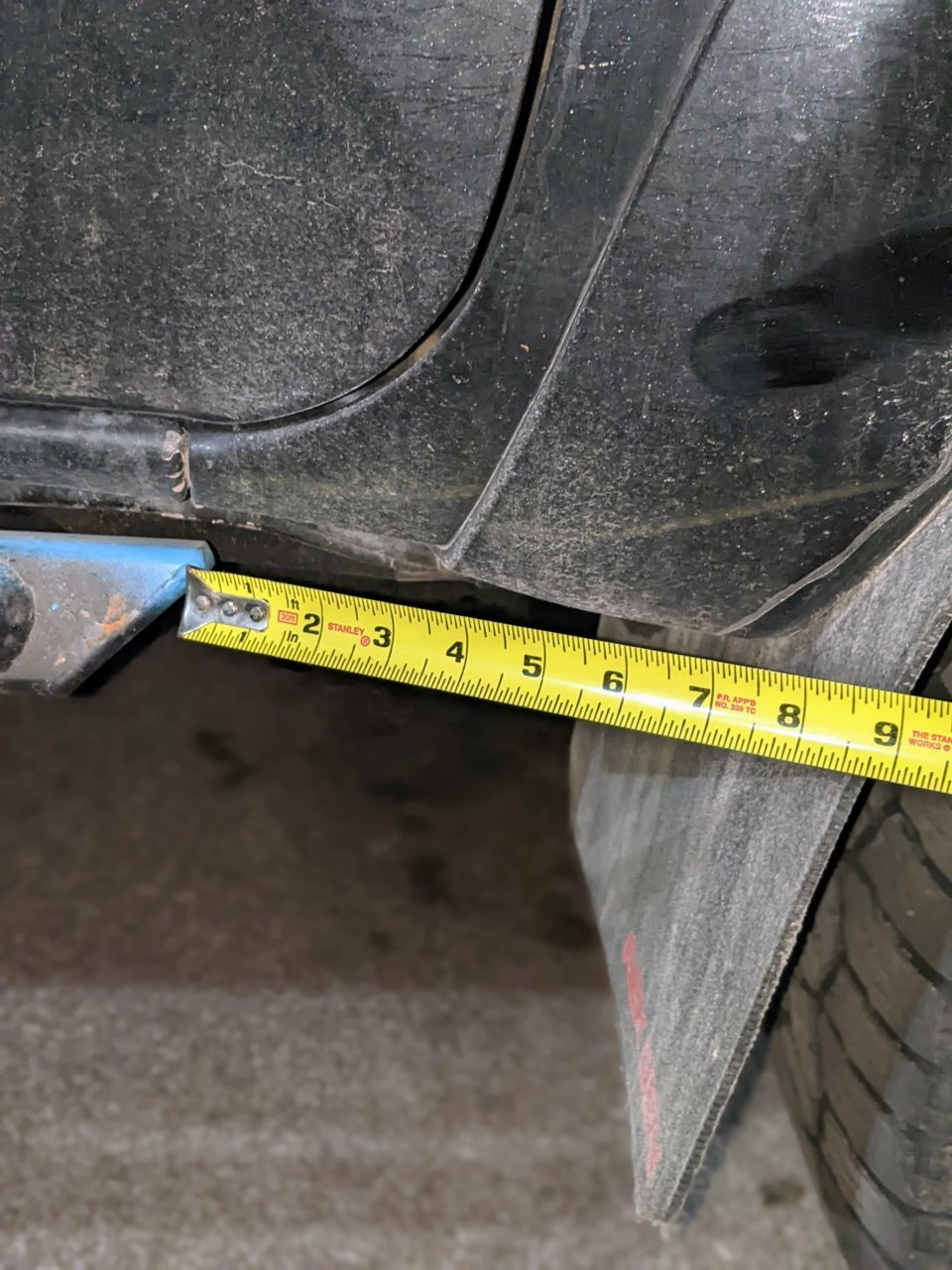

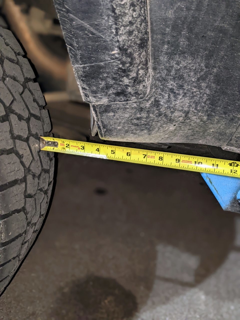

    Thanks. So yours angle up at 20 degrees? how much space do you have from the fender flair wheel opening edge front to tube and rear to tube? Seems most manufacturers run 86" or so underneath with the first tube on DCSB trucks. I am coming about two inches shy of that, so I may not be going deep enough toward the tire. If you wouldn't mind getting a measurement for me that would a help. This is the inner bar, not the outer round "nerf" tube ...

    Front
    Rear
