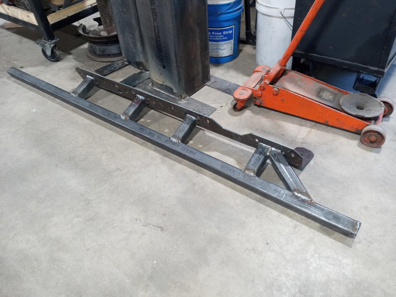

    Made some progress at lunch today:
    Kids love to see my projects-opens their eyes to the possibilities...

  3. Jan 31, 2022 at 8:45 PM
    LarryDangerfield
    LarryDangerfield One Larry a day keeps the money away ™ Moderator
    Apr 16, 2017
    #216434
    8,630
    Tyler
    Northern Wisconsin
    Black 2020 Nightshade Edition 4Runner
    Oh there will be some mods all right
    CygnusX191 and Sasquatch3153 like this.
  4. Feb 1, 2022 at 4:18 AM
    pearing
    pearing Well-Known Member
    Aug 4, 2018
    #261610
    5,215
    Wisconsin
    2015 SR5 quadcab
    Must be sheet metal... I didn't think Subaru's were meant to carry that kind of bulk. Interesting, but not my style...
    CygnusX191 likes this.

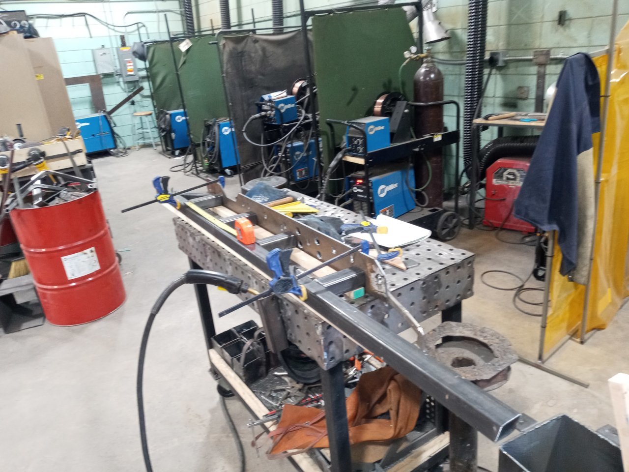

    Made some progress at lunch today.
    sparkystaco, ajmogen, Supr4Lo and 5 others like this.

    Wow! is that a Lincoln 225 I spy? I learned on one of those half a century ago!
    Supr4Lo, Sasquatch3153 and CygnusX191 like this.
  19. Feb 2, 2022 at 12:27 PM
    pearing
    Aug 4, 2018
    #261610
    5,215
    Wisconsin
    2015 SR5 quadcab
    I make all my students weld on that beast... it will make you a welder! 1/4 steel butt joints with 7018 on the buzz box is a blast...
