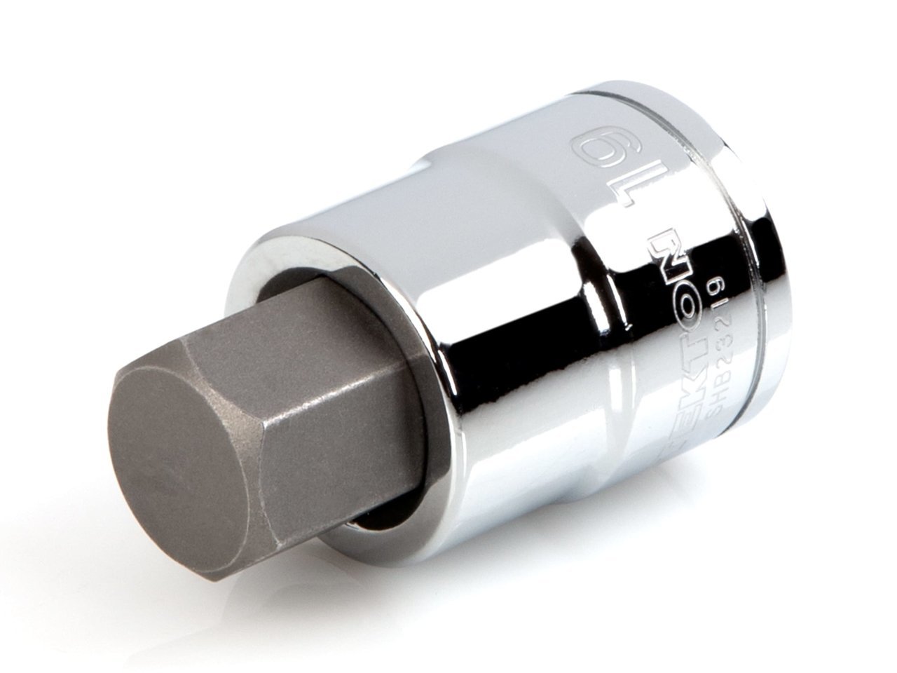

    I also need to buy a 19mm Allen.. which I also didn’t know was a thing until this past weekend. Need it to remove the wheel from my motorcycle.

    19mm Allen? Wow!

    19mm = .748
    3/4 = .750
    use the 3/4 until you buy:spending:a 19mm

    I don’t have a 3/4 Allen either lol

    find a bolt with a 3/4 or 19mm head and turn it upside down put a couple nuts on it to turn

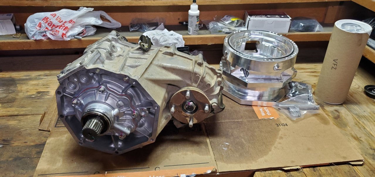

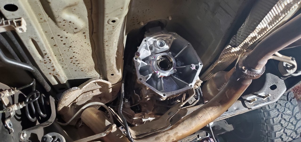

    Transfer case out. Verified the crawlbox bolt pattern is correct. Will be dropping off drive shafts to Elkhorn Driveshaft Co. for resizing Friday.
