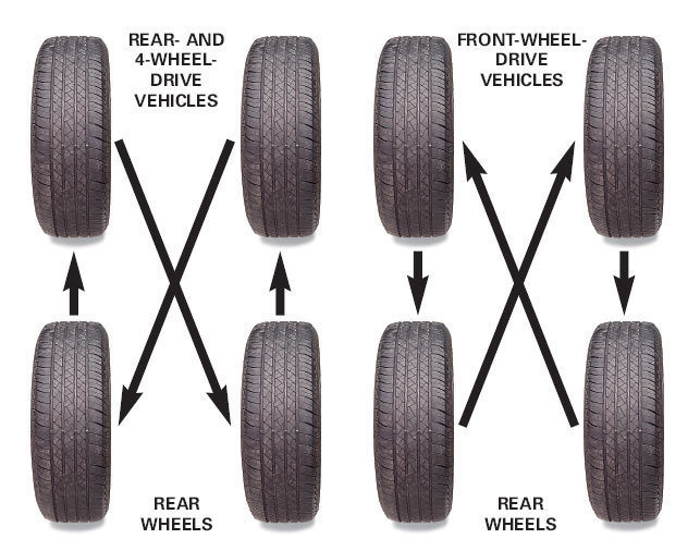

    Yes, me too! Anyone else doing the Z pattern? :tumbleweed:

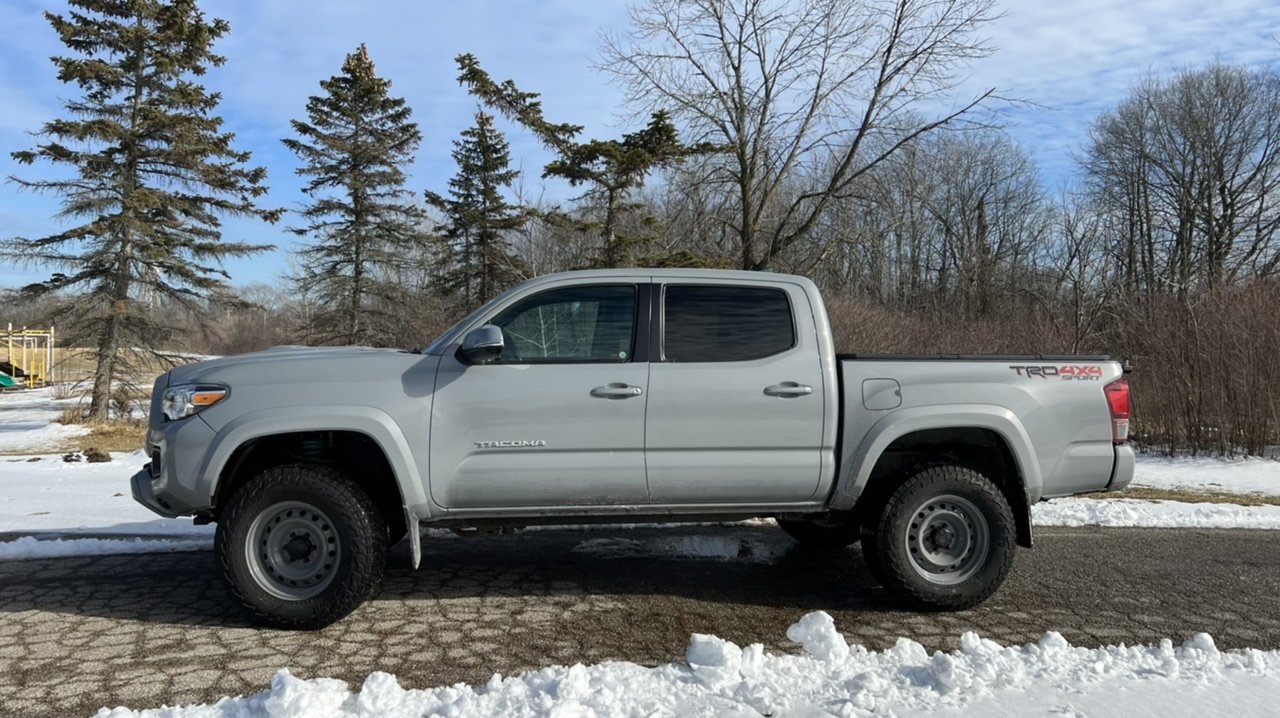

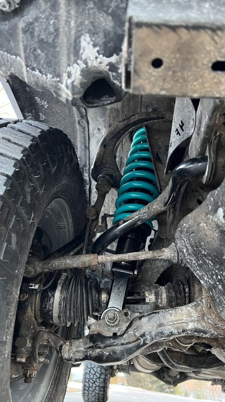

    8D719502-1A23-4850-8BF3-D4250CBBE247.jpg 1CE5905A-9E0D-4EE2-B27D-2D3952239A67.jpg DC2C3824-B415-480C-9AB3-955837497751.jpg
    Finally yes. I waited until we had those 40 degree days. Overall it went ok, had a little trouble with the tired ends and had to drop the lower control arm from the spindle to get the new struts in.
    As for ride, initially I was surprised how much it felt like the stock sport suspension. Currently the front is a bit over sprung until I get the new bumper and sliders so maybe not too surprising.
    After about a week the shocks seemed to bed in and ride a bit smoother.
    I am super happy I did it though. I ran out of time so I didn't do the ECGS bushing. That will happen this weekend if the weather holds.

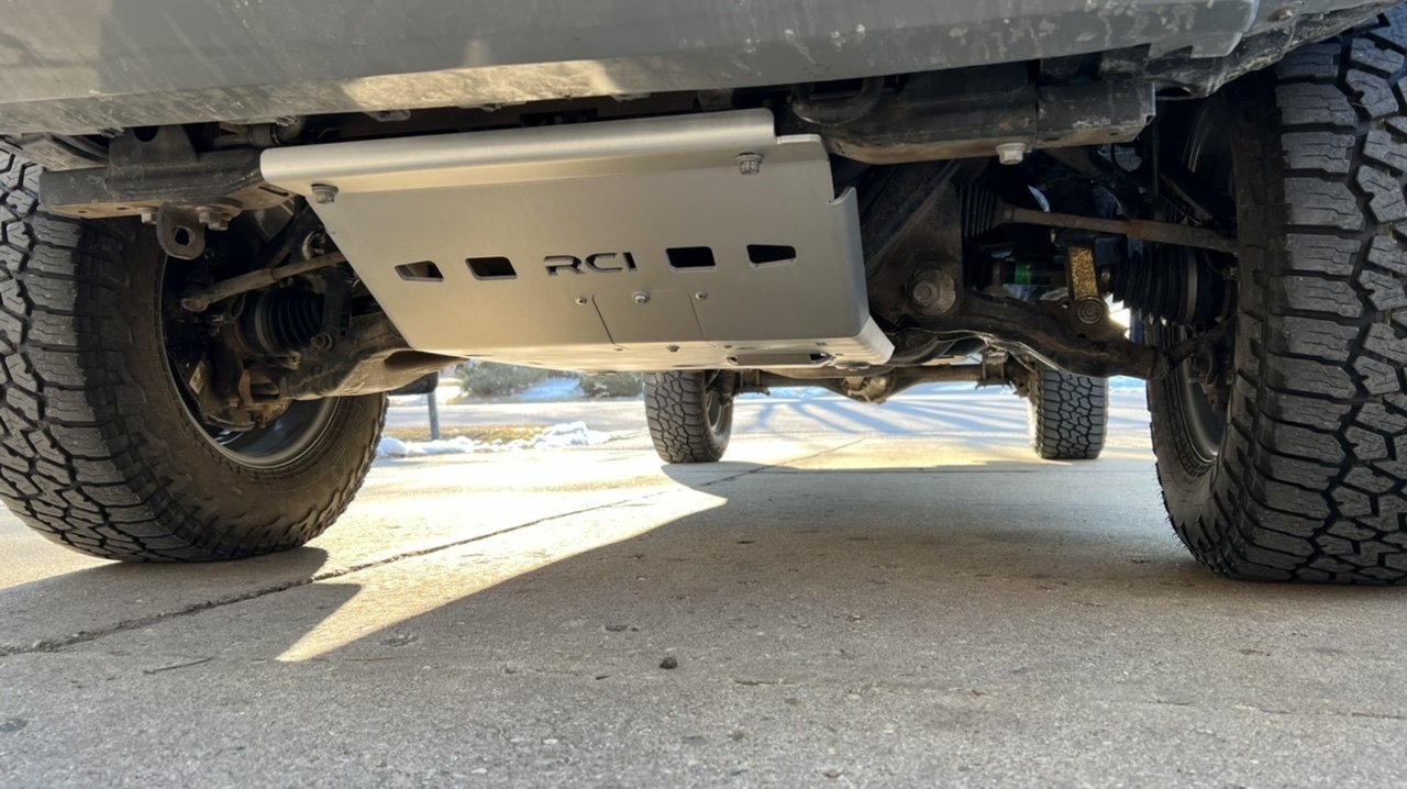

    Also I now have an RCI aluminum skid and am expecting sliders in the next few weeks.
    I heard somewhere that RCI was having a sale :anonymous:

    this is what I did last time. back to front then front to opposite rear.

    Thats how I did it this time.
