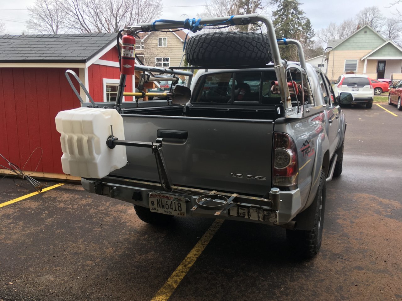

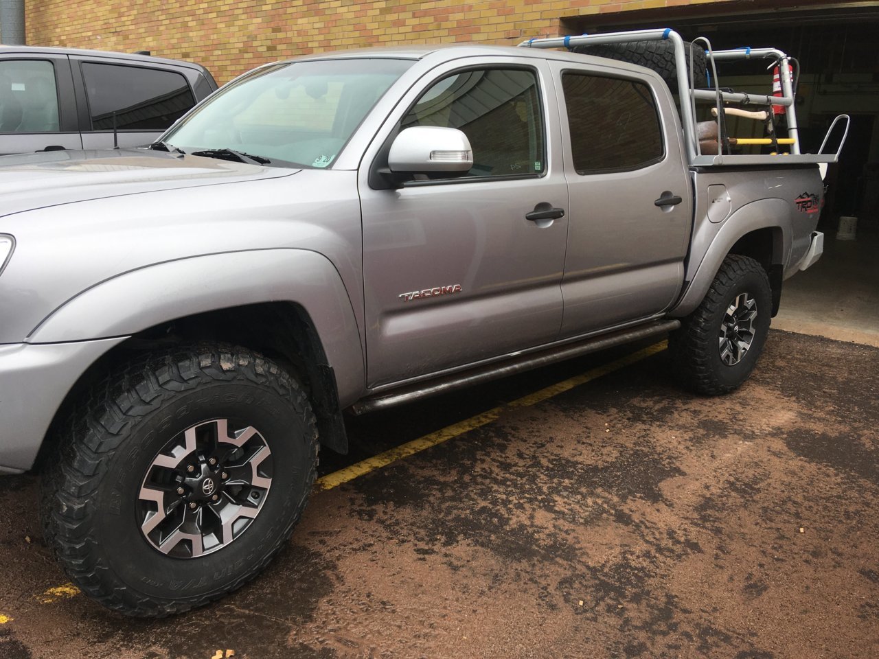

    Busy fab week. Got my 3/16 thick 1 3/4 DOM tubing back from being bent. Mitered them up and hard tacked them on. Tomorrow I will lay in the wet and take the whole assembly off so i can cut and miter the three cross tubes per side and weld the whole thing up solid. Also made a new rack to carry my water (8 2 gallon Rotopax water jugs or mix with 3.2 gallon gas cans) and propane. Still a swingaway but light and easy to use. Way up high out of the way for wheeling. My rear camera is still usable in the stock location. Happiness.

    Speaking of wet have you tested your rotopax holder with those jugs full?

    I stood on it and I am 250... That isn't likely to go anywhere; however, I am open to suggestions.

    I'd say that's a pretty good test. Waters right around 8.3 lb per gallon, with minor fluctuations based on atmospheric density at temperature. So unless you're carrying close to 80 gallons back there... You should be fine :D

    This rack was an attempt to not overbuild to the point of stupid. Easy to install, easy to use and cost me nothing but time and scrap... even had the hinge bang'in around.
