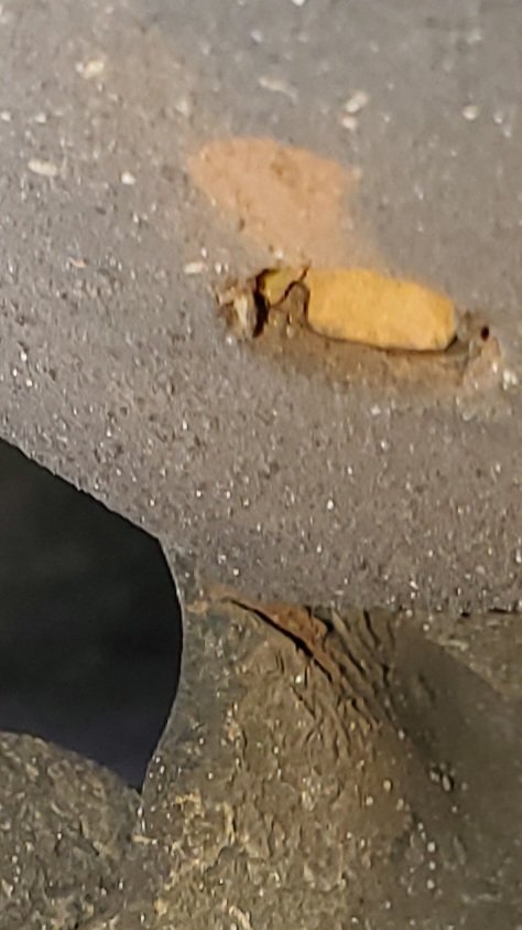

    Yep, with the bamf hangers

    I don't need hangers to run the shak
    les?

    that is correct.
    "100% .250" construction factory replacement that fits your factory hanger or our HD hanger kit."

    2019 called, they want their reposted thread back. Also it's been well over a year since OME and Dobson's started tapering their second spring so avoid this issue or at least somewhat mitigate it.
    That being said, visual inspections of your vehicles are always a good idea especially after a hard outing. :D

    Yeah, but standard eye leaf springs are just not designed to work with a tacoma shackle. Yeah, you can make it "work", but even tapering the second leaf STILL means that the second leaf is entering the hanger which is not good.
    Run a leaf system with a berlin eye if you're going to use hangers and shackles.
