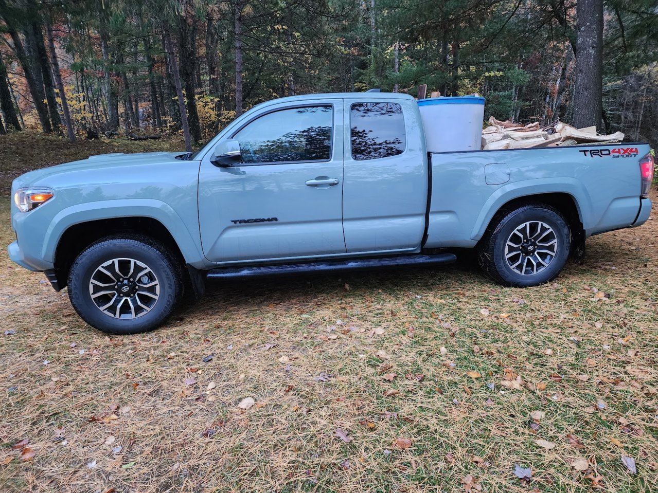

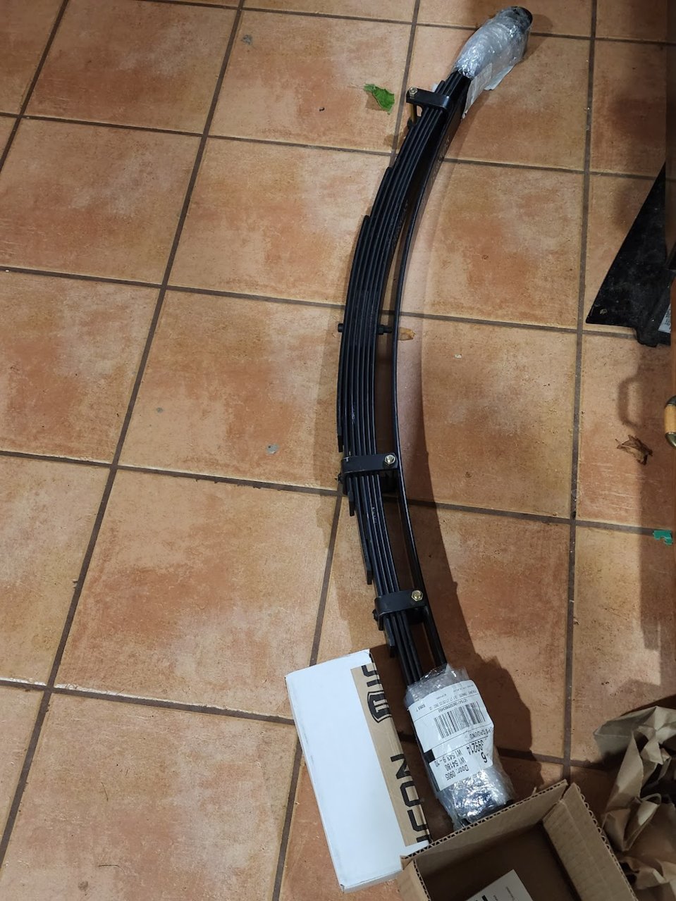

    Some of my stuff started coming in, went with RXT leafs/5125 rear, debating on setting 1 or 2 yet...my truck has been squating non stop with scrap and firewood haha

    3" lift? A.R.E cap 285/70/17 moto metal 955 17x9
  9. Oct 18, 2022 at 8:23 PM
    grizz_wi
    grizz_wi Well-Known Member
    Aug 4, 2016
    #193715
    147
    Green Bay, WI
    2022 Lunar Rock AC 6MT
    Perfect I will go that route, itll probably give it a nice rake lol
