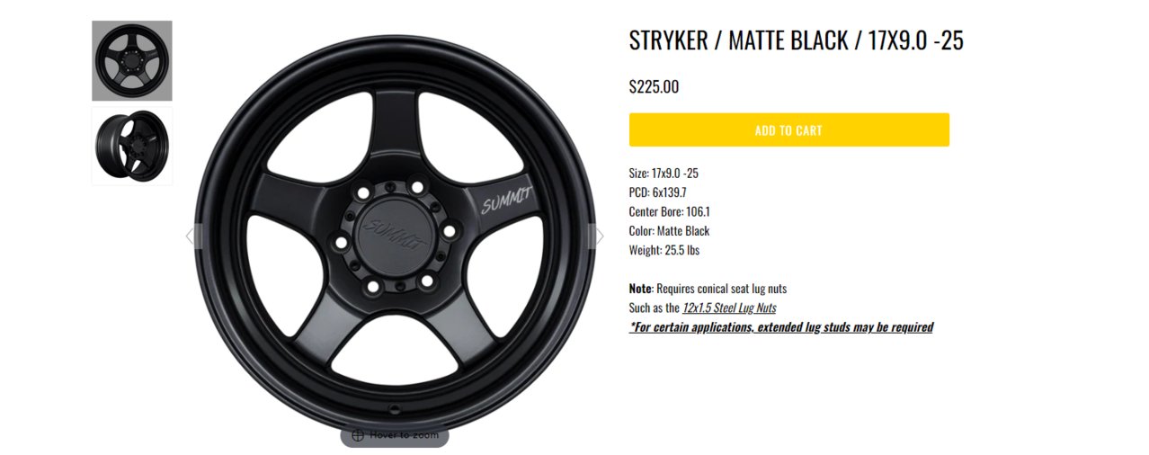

    Look at this thread for stock offsets.
    https://www.tacomaworld.com/threads/wheel-specs.30754/
    I'm also pretty sure a -25 offset wheel with a 265/70R17 will rub without some alignment magic.

    Stock 3rd gen wheels are 16x7 +25mm offset, same as stock 2nd gen wheels [source info]. 25mm is about 1 inch, so a wheel with -25mm offset will stick out 2 inches further and certainly past the edge of the fender flares. Depends on what style you are looking for if that is desireable or not.
    My current wheels being SCS BR6 17x8.5 -10mm offset stick out more than 1 inch further and line up flush with the fender flares. Had to remove front mudflaps and front air dam on 2nd gen but 3rd gen might not have to, you guys seem to have a tiny bit more room.

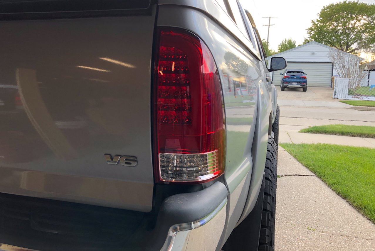

    Edit: Reference photo of how far a 265/70/17 pokes out on the aformentioned 17x8.5 -10mm wheels:

    That offset looks like perfect it just seems hard to find a wheel that I like that has everything that I am looking for. I am hoping I will be able to maybe get some wider mud flaps because I don't want to be scratching up my paint with rocks since I have to commute down a gravel road every day.

    Just noticed you have a '15, you're gonna need to remove front mudflaps for sure unless you already have aftermarket UCA and moved the LCAs forward for clearance.
    Once you get clearance from all that jazz there are aftermarket mudflaps from several vendors like Rekgen, Rokblokz, etc.

    nope just a fully stock tacoma suspension wise. Thats why I am thinking now -25 isnt a good idea. I kind of wish some wheel companies just gave you more options when it comes to offset and rim size.

    A good tech can get the wheel forward with the stock LCA cams etc. The big issue is if there is enough for how for out they are. You will clear the UCA with this. @wi_taco clears, but you will be out further on those rims... about 2.17 inches from stock per the site I gave you.
