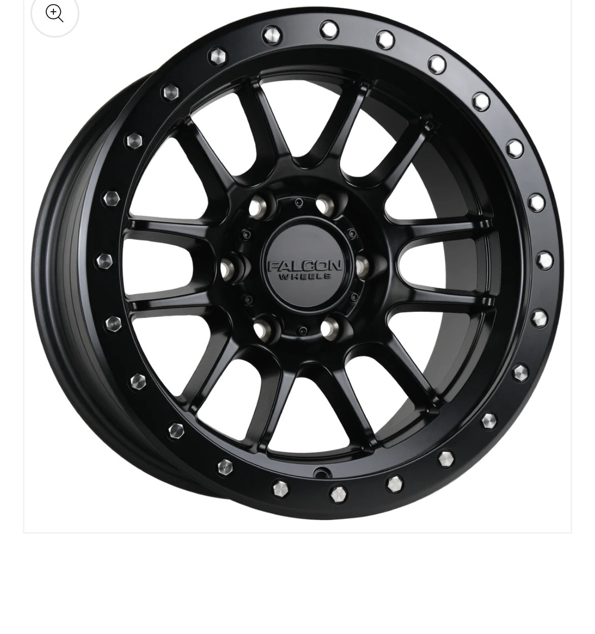

    ok so these are the wheels I think I’m set on but I got a couple questions so with 265/70r17 and a -12 offset would I have rubbing I know that’s the max tire you can have on stock suspension without rubbing but idk if that offset would cause some rubbing. Im fine with doing some trimming as long as I can keep my mud flaps. Also another question it says I need to use conical acorn style w/60 degree tapered end lug nuts but how do I know what size to get?

    Can't speak on offset.
    Lug nuts are 12 x 1.50

    At one point I had that size tire combined with a -10 offset wheel. Rubbed slightly on the plastic fender liner when backing up and steering at full lock. Nothing a heat gun and minor trimming couldn't solve. Not sure about the mud flaps, I didn't have any installed.
    Edit - This was on a 3rd gen, just saw you have a 2nd gen.

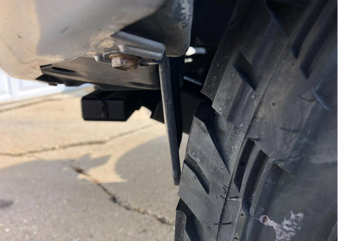

    I have that exact combo now with the -10 offset. If you are still using stock UCA and alignment specs it will rub at full lock in reverse going down a driveway, and will definitely rub on front mudflap and the little air dam on lower part of front bumper. Removed both of those and fixed alignment, no more rubbing.
    Edit: image of the front air dam thingy, probably there for EPA/MPG but frankly I found it's relatively useless.

    The front air dam is basically a gimmick for EPA. It's funny cuz half the trims don't even have them. But if you get a tundra capstone limited or sport, it has an electric air dam that's self-deploys when you hit certain speeds. Very cool. Very obnoxiously useless and in the way all the time.
