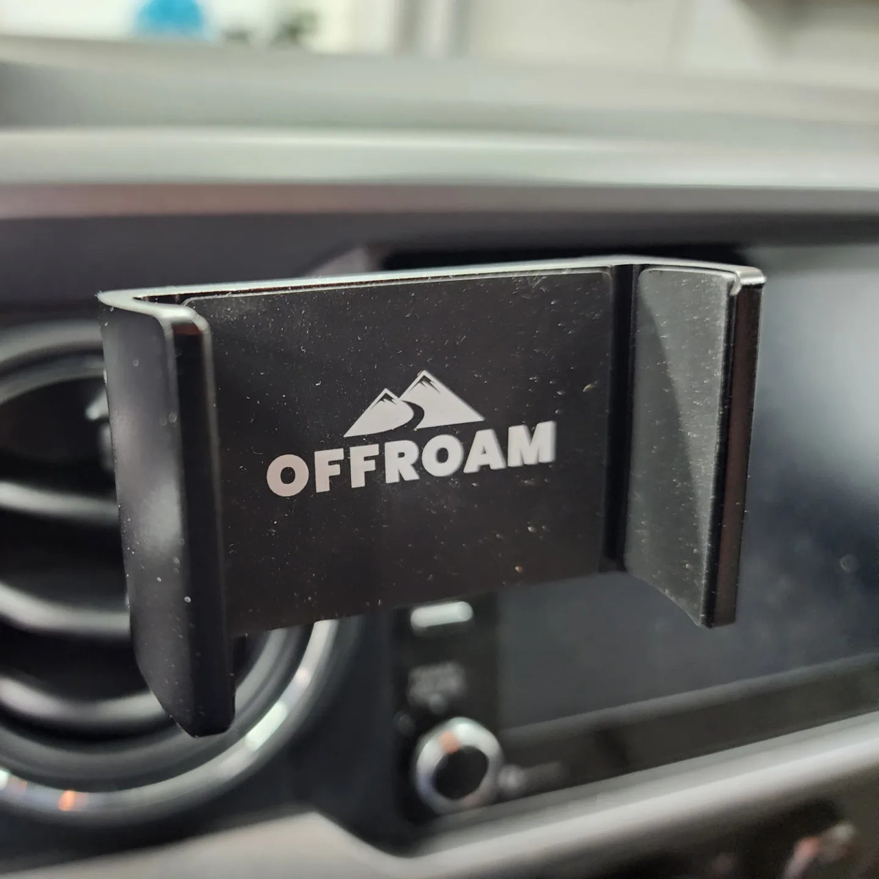

    Installed my center carrier bearing drop today and my offroam phone mount, solid mount, I like it. Having a slight vibration on take off since lifting the rear, hopefully that does it20221201_140113.jpg
  6. Dec 1, 2022 at 6:42 PM
    WiscoPat
    WiscoPat One does not simply purchase a Ridgeline
    Jan 1, 2019
    #277680
    1,845
    Pat
    Wisconsin
    2019 TRDOR Tacoma 1995 JDM 80 Series
    Mall Rated
    One of my top favorite mods on the taco, hands down - a beautiful match of form and function. Hope you like 'em!

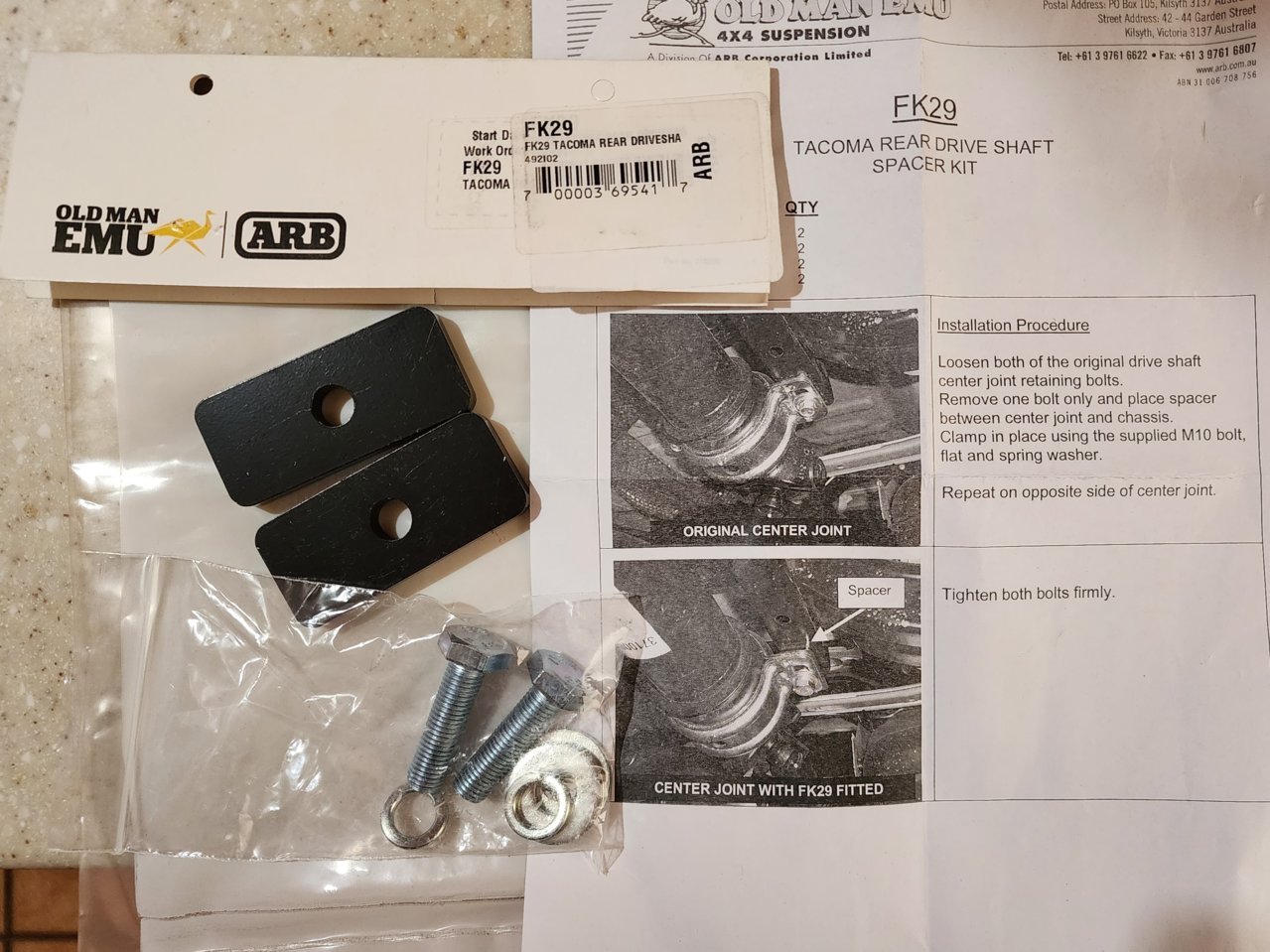

    I'm fighting the same vibration. Drop didn't fix it. Axle shims from toytech are on their way

    I'll find out tomorrow when I take it out, let me know if the shims resolve your issue!

    shoulda said something, got 3* shims rattling around in my truck.

    Depending on your lift the drop might be wrong ie: too thick or not thick enough.
