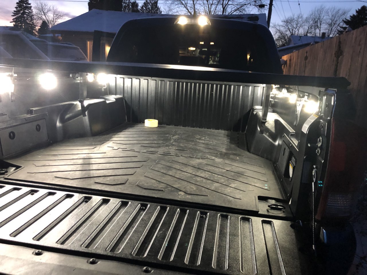

    That looks like a sweet under hood setup. I want lights there too, but...
    ...THIS looks great! I think I may go ahead and try this out for the bed! Thanks!
    Yeah, saw that Amazon has about 3 million choices for LED strips. I really like the simplicity and completeness of the kit from Matt Gecko.
    Perhaps my only decision now is white or blue lights. :spending:

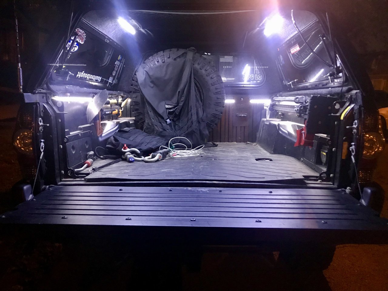

    So. Many. Stickers.
    White. You'll regret blue when you're tired and looking for something.
    Also, DD rock lights would work in there

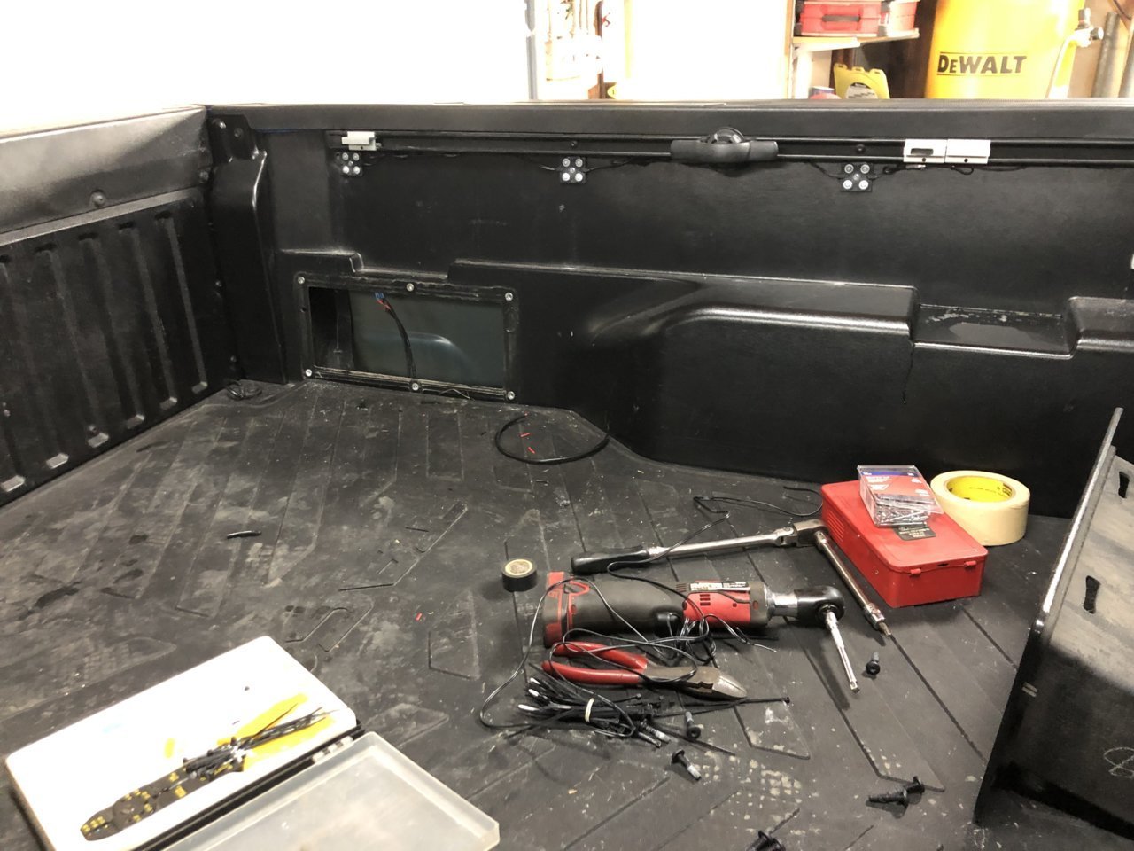

    I don't have pictures, but... I bought a light kit from someone-maybe MESO Customs? and installed it. Put a switch just inside the bed and made it so it could be on a pressure switch from the tailgate or turned on with the switch in the bed. There are not a lot of options on the pressure switch and it has since failed. The lights are LED and run around the perimeter of the bed just at the rail. Like it alot. Took a morning to wire up. I can get you more specifics after work if you need them.
    Edit: Matt Geko! That is who I got the kit from. He also stood behind it when it failed a few years later!

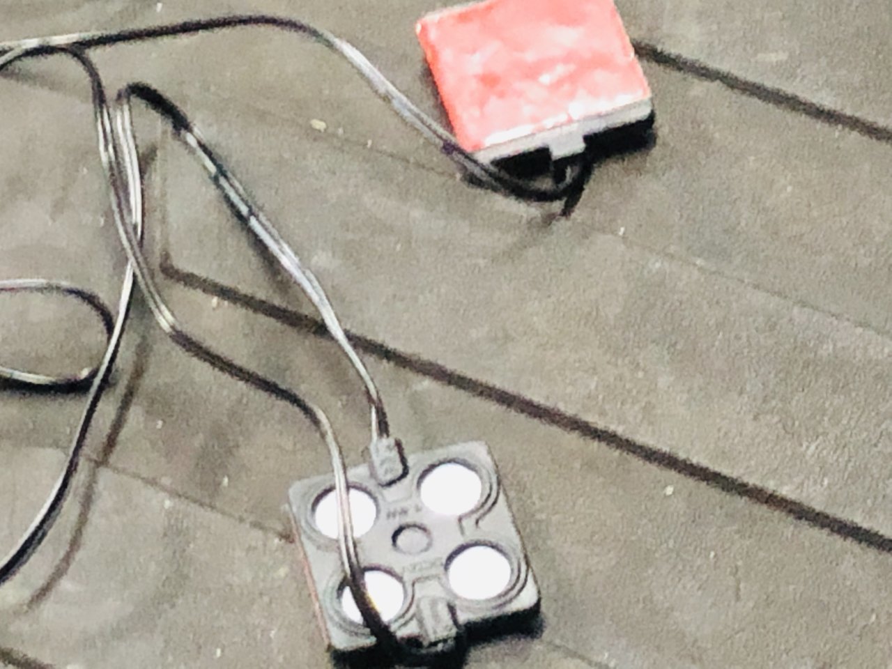

    My neighbor bought these lights on eBay as a Christmas gift and installed it a few years ago on my 2017 Sport.
    Since I traded that one in I need to do this on my 2021 Tacoma.
    XPRITE Lights led
    He installed them just under the Tacomas rail system using rivets. The lights are also hooked up when you open the doors or use the cargo light switch that’s in the 3rd brake light. (I know that light switch came standard on the 3rd Gen TRD models)

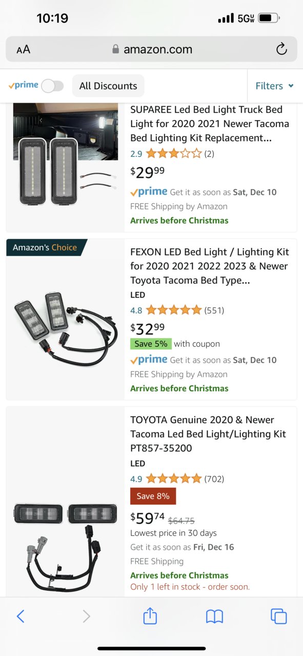

    My 2021 has the pre cut slots in my bed for the Toyota Factory bed lights. Just need to pop the 2 panels off.
    https://www.amazon.com/FEXON-Lighting-Replaces-Toyota-PT857-35200/dp/B08NV56PBF?crid=2XRMN2PVJGY8X&keywords=tacoma+bed+lights&qid=1670516346&sprefix=tacoma+bed+%2Caps%2C149&sr=8-3
