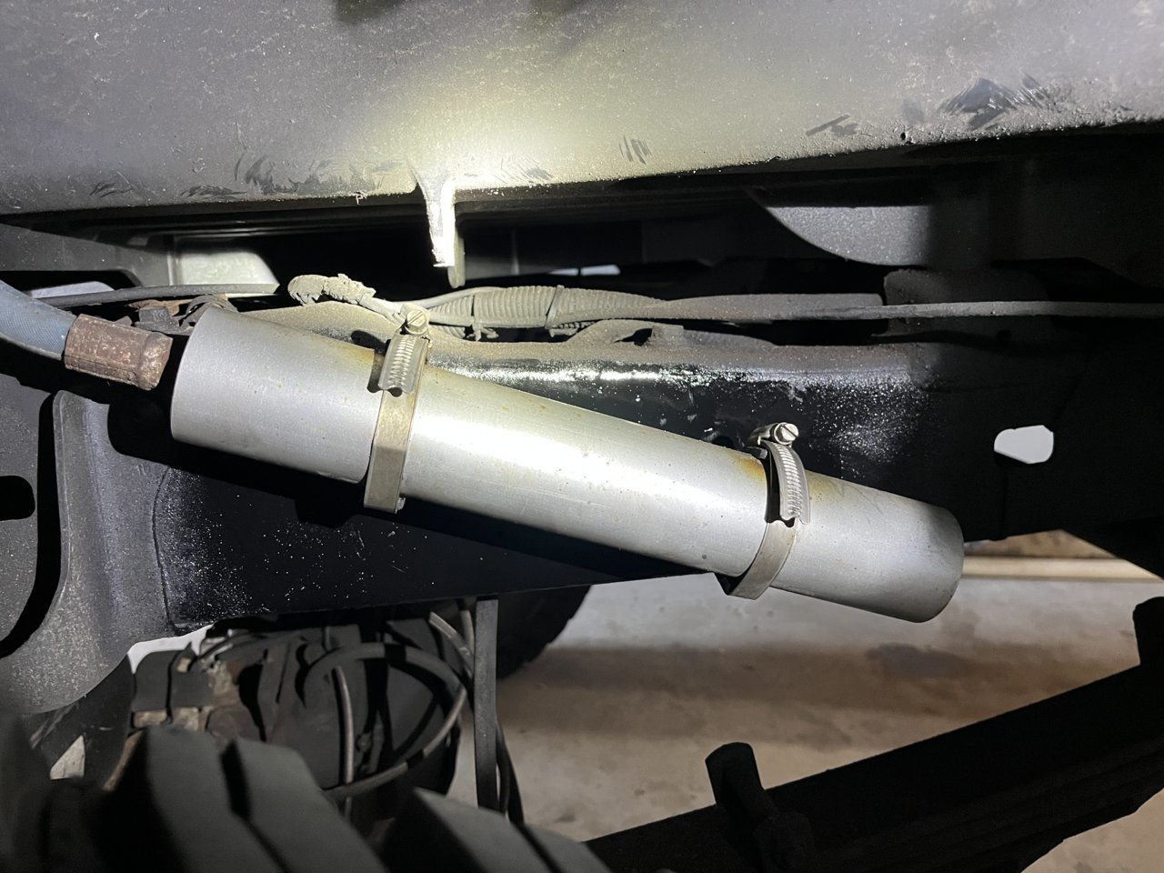

    I had resi mounts welded to the frame:

    Strap it to the frame rail. Where else are you going to put it? I use the mix of worm gear/ band clamps and super heavy duty zip ties. And I wheel the snot out of my truck, never had one come loose.

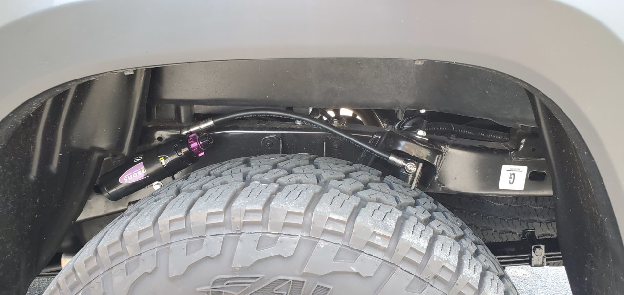

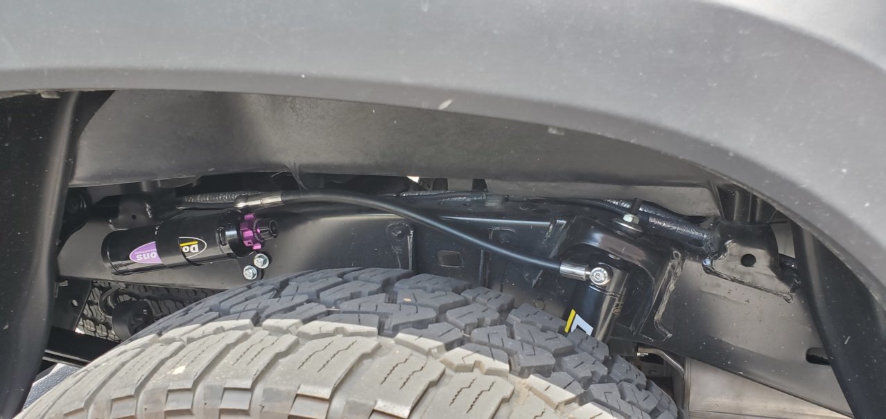

    Should have come with a brackets for the reservoirs. Mount to the frame rails. I drilled and tapped mounting holes. Driver side forward of the axle and passenger rear of the axle seemed to work best. Here are two pics of where I had mine mounted.
    Driver side
    Passenger side
    wi_taco, sparkystaco and CygnusX191 like this.

    Thanks for those. Its so... clean.

    I think at that point the truck had less then 2000 miles and hadn't seen dirt yet. It was nice to work on it then, didn't get the face full of dirt when laying underneath.
