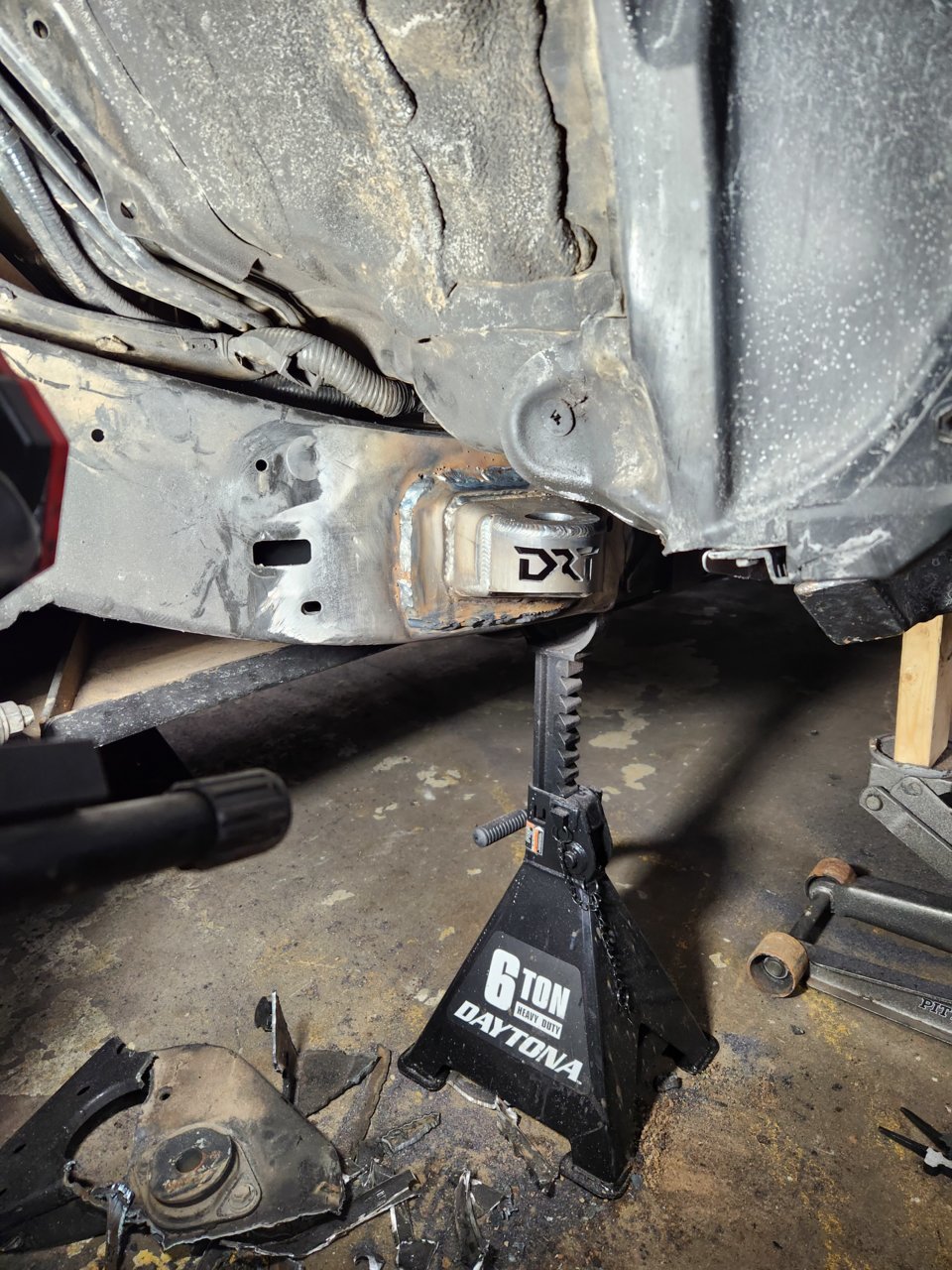

    Yep. Those old cab mounts are really on there!
    Figured might as well go all in. See so many posts of people having to redo CMC's because it wasn't deep enough and I only want to do it once.

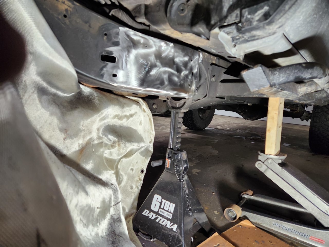

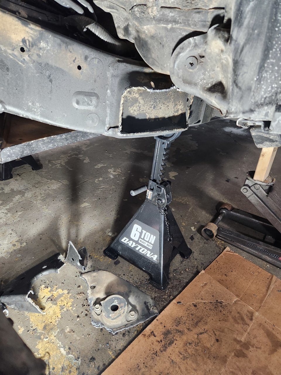

    Future plans. Maybe after the 35's are done.
    Factory junk all removed and ready for welding.

    I have jack stands under the frame. The jack and 2x4 are just lifting the body up slightly get it up off the body mount.

    Not my best welding work, but what a pain to get at. Specially with the huge gun on the miller 350P im using at work. I definitely need more practice on out of position welding.
    I did smack it and say "that's not going anywhere" so I'm covered!
    Real sad thing is I have a whole nother side to do :annoyed:

    How long it take for this side? Thinking this is a full day kinda thing... You torch it off?

    Used the plasma cutter to get the bulk of it off, then cut off wheel and air hammer with a chisel, and a final clean up grind. One side took me about 6 hours. And that's about my limit for laying on the floor is.

    6 hours seems like a really long time for that

    No kidding! I’m thinking an hour, two at max!
