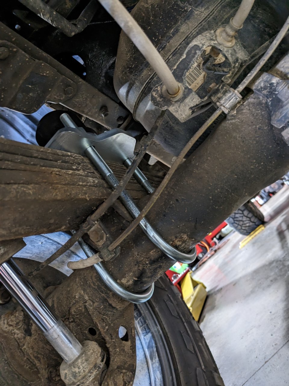

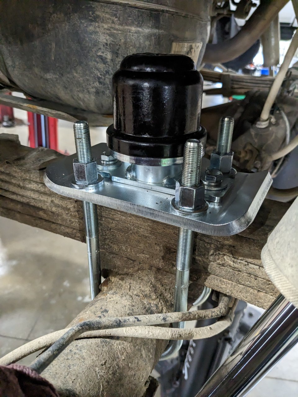

    So. Many. Stickers.
    Thumbs up to every post from today. Looks like everybody got some good work in!

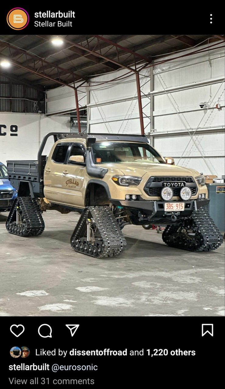

    @pearing you could probably make use of this with all the snow you've received...granted it's a third gen, but still!

    OK, what brand...I swore I wasn't going to spend anymore money for a while.

    I can't answer for Cygnus but those look a lot like the Wheelers u bolt flip kit with durobumps (or something resembling them). Lots of kits for that now on the market, Archive, AccuTune, Timbren, etc etc. I'd definitely make sure to paint/powdercoat them up here in salt & snow land though.

    At the local ski area the guy running the place bangs around in a 3rd or 4th gen 4Runner with tracks... I need to find a money tree... Gears and lockers, gears and lockers, gears and locks...

    Wheelers kit with super bumps.
    Steel is coated (zinc? Wrong color, same idea), no need for paint. Just hit with fluid film once yearly when you do the rest of the truck

    If looking for ubolt flip with bump stops check out Archive Garage with Option 3 bumps
    I've had both, and while Wheelers kit is great over stock I feel the Archive kit is better. The Archive bumps are more progressive and don't hit as hard and the top plate is beefier. The top plate on my wheeler kit actually bent on me and that was the cause for the change to the Archive kit

    The wheelers top plate is beefy enough that if you bent it.... Either it wasn't installed correctly, or you were doing dune jumps or something lol. :bikewhoops:

    After I installed it I went back at a later date to do some leaf spring stuff and had them off. When reinstalling the plate bent before I got to the 80ft torque. So :notsure:. I'm not saying wheelers is bad, just one guy on the internet experience.

    Seeing a snorkel on that makes one wonder exactly how deep is the snow?

    The stock intake is in a terrible spot, especially if you take your fender liners out. Aside from the looks, I assume they snork'd that thing to move the intake out of the direct throw of the tracks.

    90ft is what they call for now. Maybe they have newer plate design?
    Agreed. Gonna do the same to mine.... Eventually
