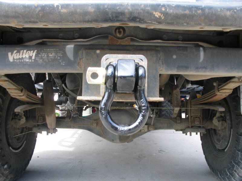

    For the rear, you can always get a receiver hitch shackle. Elite's shown:

    Lifting off a receiver shackle is near impossible on the trail. The truck will lean on way or the other and the hi lift will slip out.
    To answer the OP's question, the tire attachment is the only way to use a hi lift on the trail without sliders or steel bumpers. You'll need to carry a jack stand as well if you intend to change a tire.
    You might be better off with an aluminum SUV jack on a sled.

    Jacking in a shackle is sketchy at best, especially if you're on a not-perfectly-flat surface. You also get the joy of chocking the front tires.
    The right answer to this problem is: Get sliders.

    Thanks for the responses. Looking into the bumper jig. Would using the tow shackle on paved roads be ok, or same issue as off road? As for sliders, will bolt on sliders be effective for jackong or must I get welded?

    Same issue.
    Never work on a truck on a hi lift. It's fine to use the hi lift to jack the truck up, but set it down on jackstands immediately.
