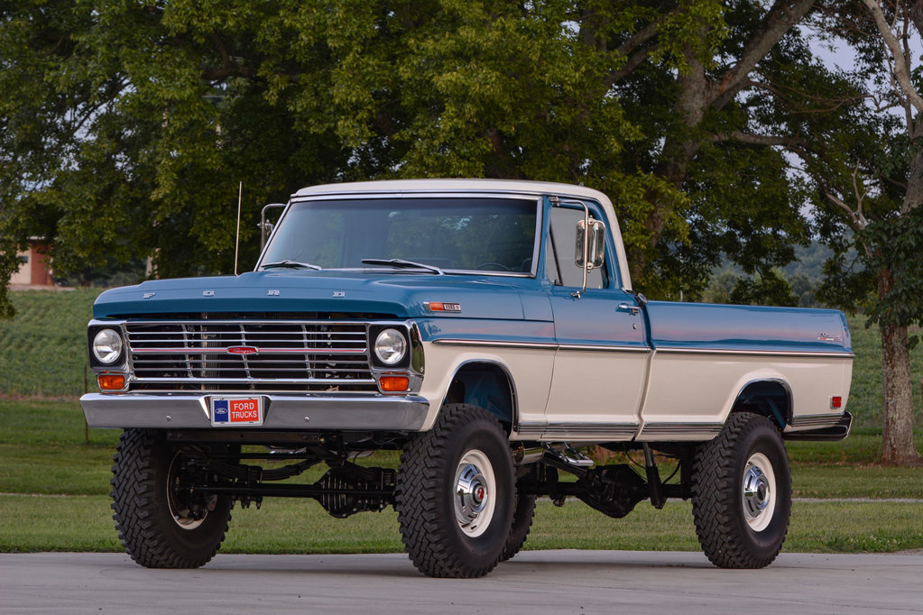

    Ford F250 factory suspension from 1967-1977. This was about 4" higher than the 4X2 version and was the most extreme. But just about all 4X4's until the 1990's were about 2" higher than 4X2's
