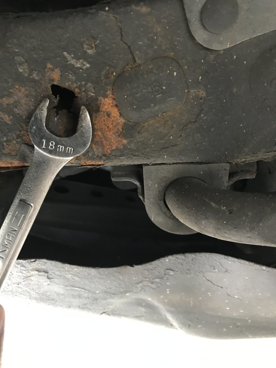

    Update: Service rep called. They forgot to get a pic of the signed paperwork next to the hole to prove it's my truck so I'll be taking it in the morning. He said it looks like it will get approved and that he will fill up my tank for my trouble.

    My paperwork from dealer says “qualifying perforation found” so now needs approved by Toyota.

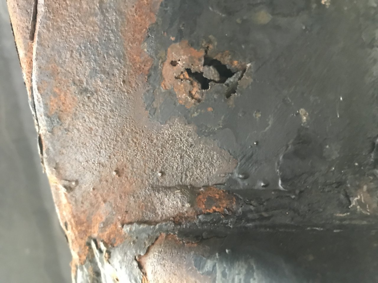

    Claim denied. Dealer said Toyota said “outside influence” so apparently you’re suppose to be able to put your hand through your frame.

    That’s what the dealer implied. Spoke with a lady at Toyota and she has me on hold. I tapped around with ball peen on other areas that night (Friday) because I was going to start cleaning up and trying a rust converter on Saturday. After that, took wheel off to replace axel seal and noticed bad spot on the frame. So then I pushed in the middle of it and it popped. She just took me off hold and confirmed that me pushing in on it counted as an “outside influence” and would need to escalate the case.

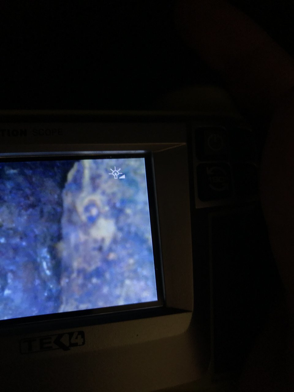

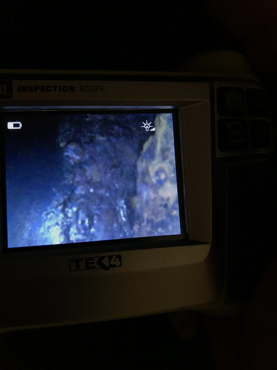

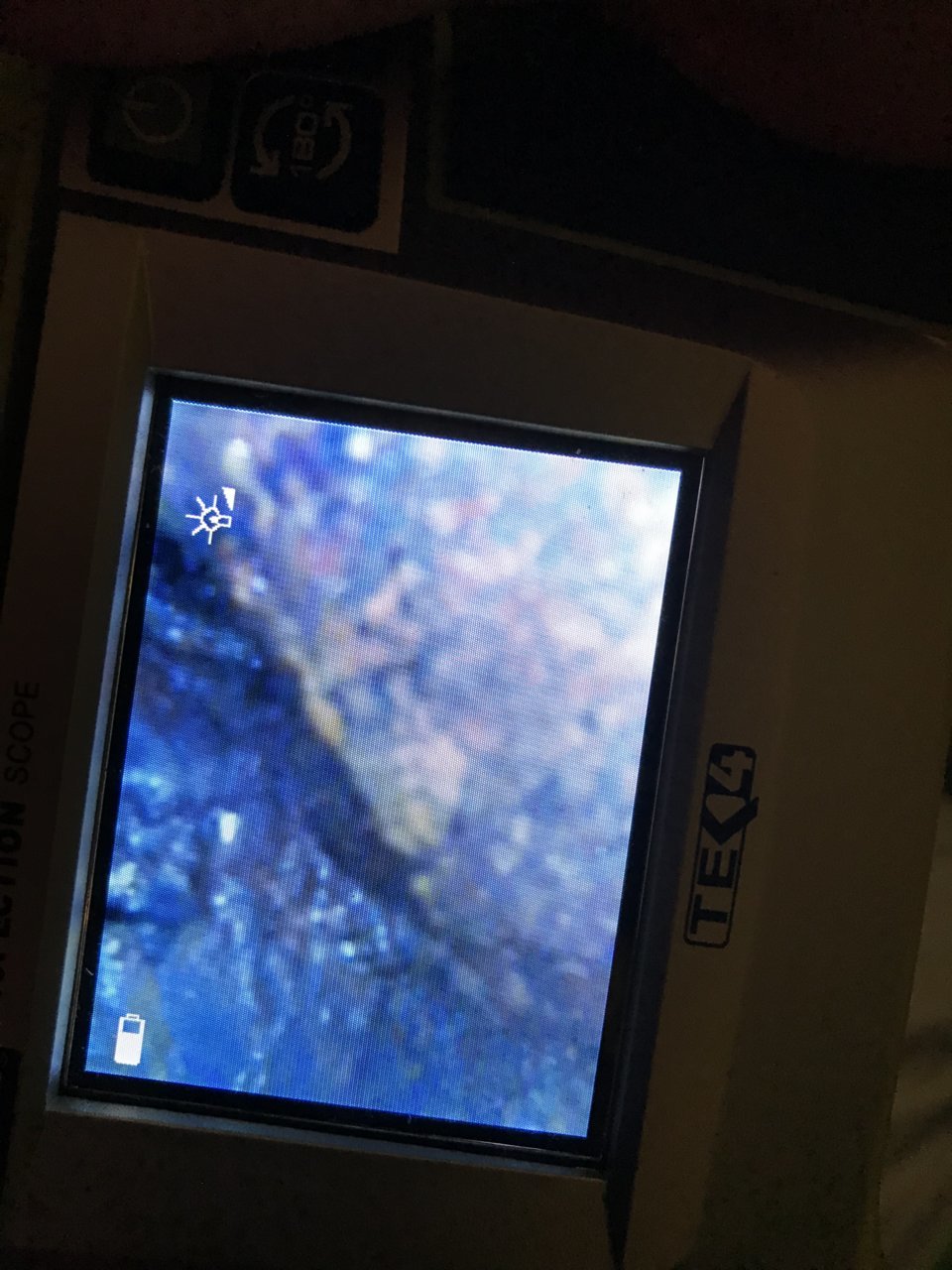

    Ok, ok one more post... shitty pics from the inside. Best I could do.

    Followed up with Toyota since I hadn’t heard back. Tier 2 lady said the denial would have had to come from regional manager and she can’t override herself but would follow up for more inform. Also let her know I found this on Saturday and she’d let him know about it. Afraid to look at this one cross eyed.
