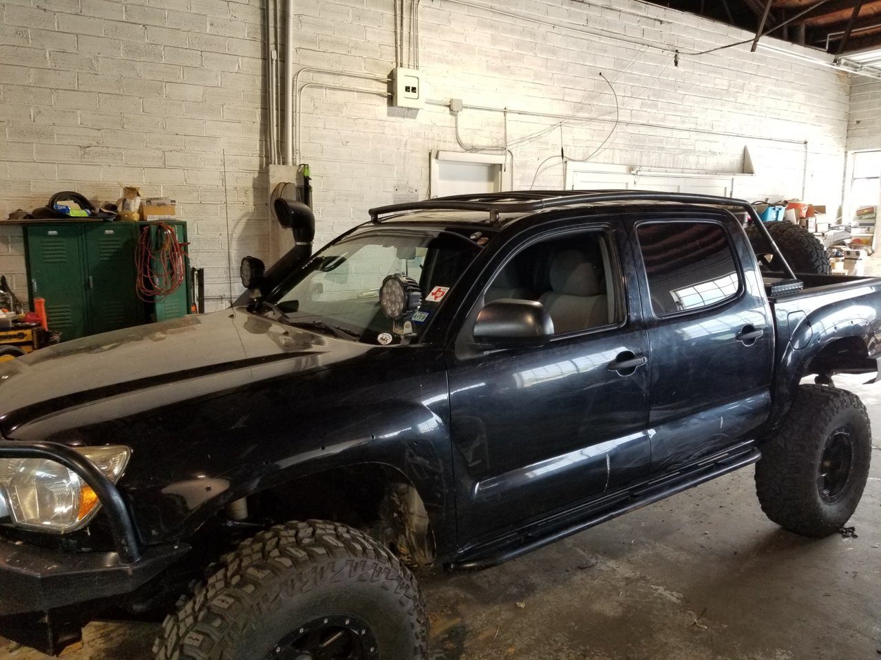

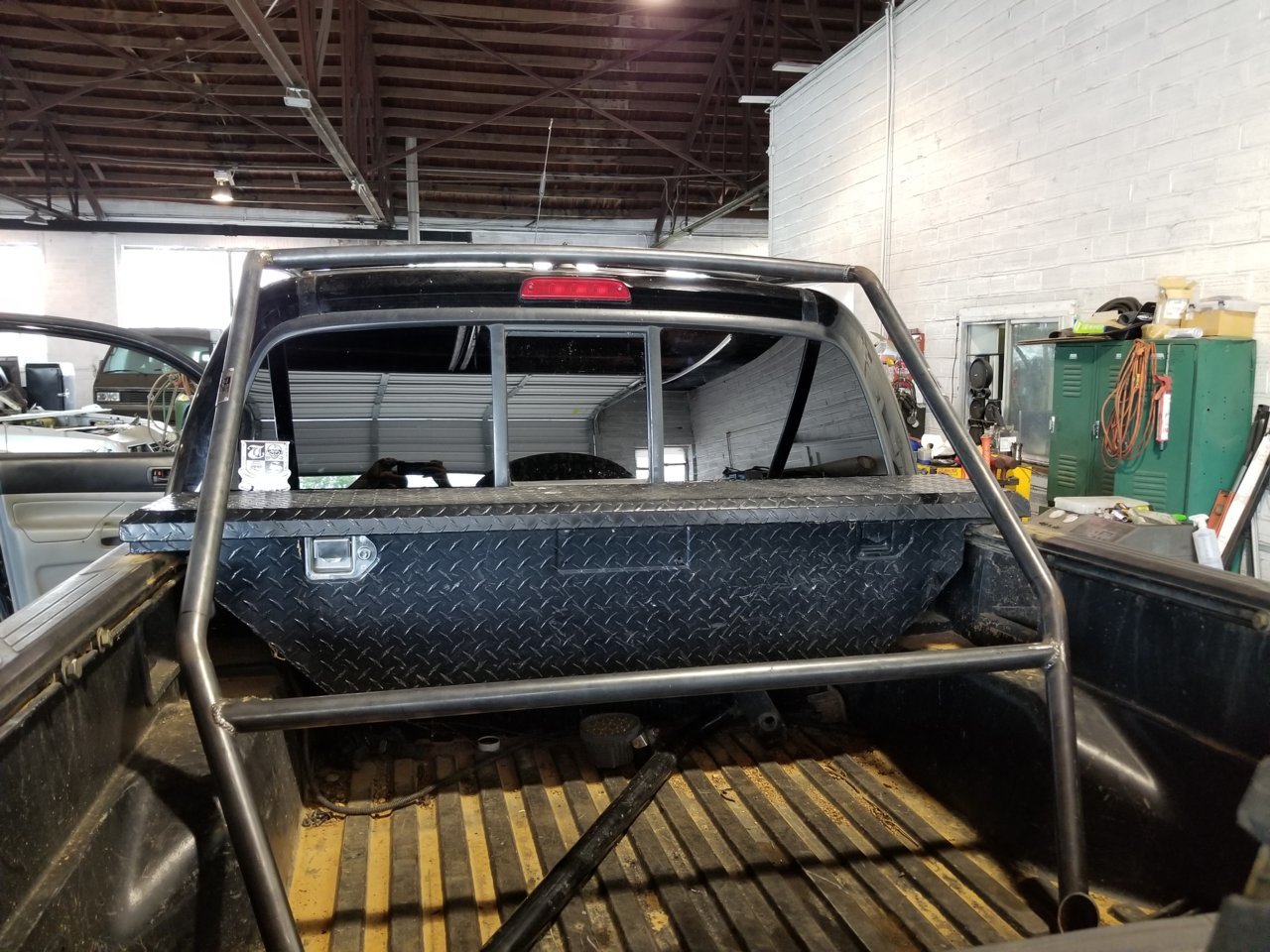

    Cut the fenders, massaged the inner fenders and cut the cab mount back. The rear was fine when I had all pro expos but I got rid of those
    No it's not full it's just over the cab. The rack over the roof is tied into the cage through the roof and mounted to the bed bolt mounts in the rear
    You can kind of see the legs poke through on the second pic

    No I do not have a bender or experience doing that type of tube work unfortunately.

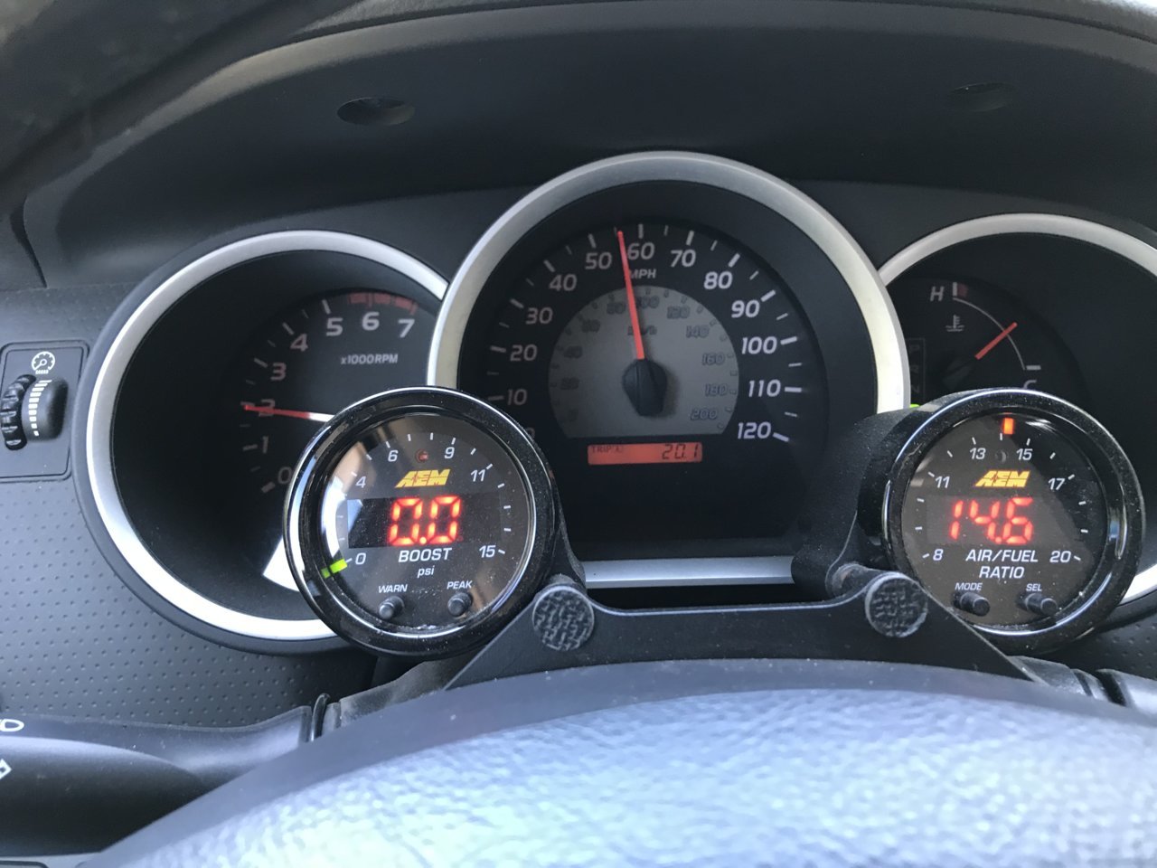

    Proof haha. My speedo is 10% off so that’s why you see 55-56 mph. The GPS was 60-61mph. RPM needle is just below the 2k. I took this for another member in the S/C thread who was also curious.

    Brother, that's the reason I made the post. Math doesn't equal REAL WORLD. Real world is what matters, thank you!
