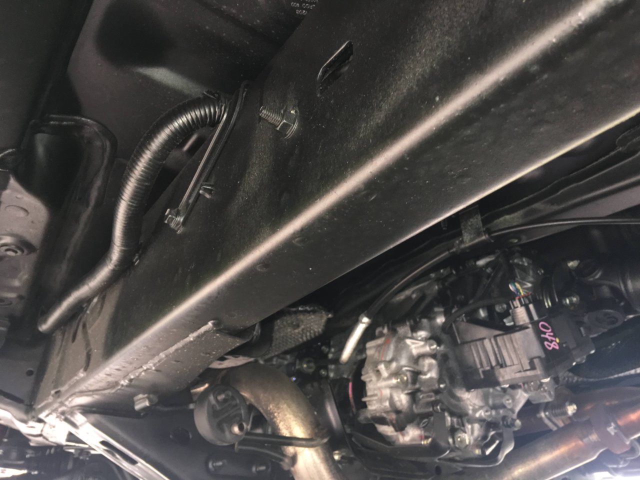

    So today was the day. I got everything ready, I really shook and mixed the Cavity Coater stuff, and hooked up their spray gun that came with their kit, and........nothing. I fiddled with the dumb thing for almost an hour and even invented new cuss words, but no go.
    Their stupid gun design uses the venturi effect to suck out the goop by the air rushing past the top of the inserted tube. It simply doesn't work at all. I turned the pressure dial and even tried my buddy's huge air compressor and still nothing. Crap gun design. He let me use his Fluid Film can and gun and it worked beautifully! So Monday I'm going to have harsh words with the company, and get an RMA to send back their chinese crap sprayer. SO not happy.
    But the stuff itself is great. It smells like...well...leather lotion, if you can imagine. Not heavy or harsh at all. It does have a slight petroleum-chemical after-scent but overall I can live with it. I coated all metal under the truck, didn't focus on the shaft or near the wheels but got everything else, even on top of the transmission/trans case and all around and down the frame members. Everything has a light coating and looks wet now. Parking it for a few days outside to let it all drip.
    Did not do inside the doors or the rocker panels because there aren't any holes big enough for the hose. Going to buy a can of the stuff since it comes with a tiny spray nozzle tube that will fit in the grommet holes in those areas. Hoping this wasn't just wasted time & effort since I'm coated in the stuff, even breathed it in lol...prob gonna get cancer and die in 20 years or so...whatevs.

    No, that's the fluid film gun design. This one has an air flow regulator dial on the left side of the handle to regulate how much stuff it pulls up because it regulates how much air goes across the top of the pickup tube. Totally crappy design for this application IMO. But thanks, I was glad when it was done. I know I missed areas, but figure something is still better than nothing since Toyota seems to not have good steel for some weird reason.

    I bought this extension tube assembly off ebay that i was able to adapt then attach on the straw those rp-342 cosmoline rattle cans with, to get deep inside those frame sections, in the rockers, and other hard to get places.
