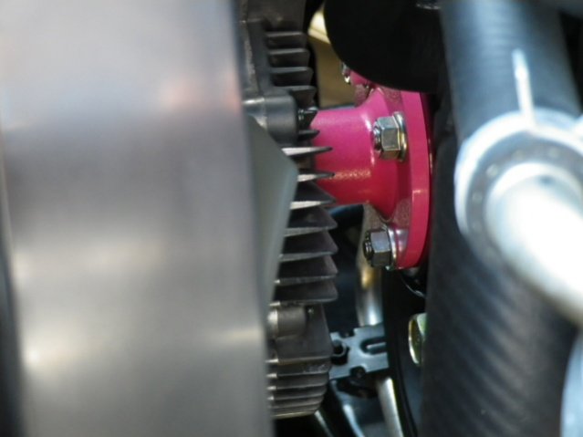

    Oh there will be some mods all right
    Another way to tell if you have the tow package is if your fan has pink on it.

    A few OE parts from fancy trucks
    Looks like a small radiator in front of the condenser in front of the actual radiator
    You should be able to follow the connected lines to the transmission

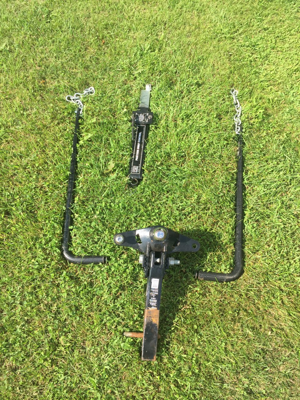

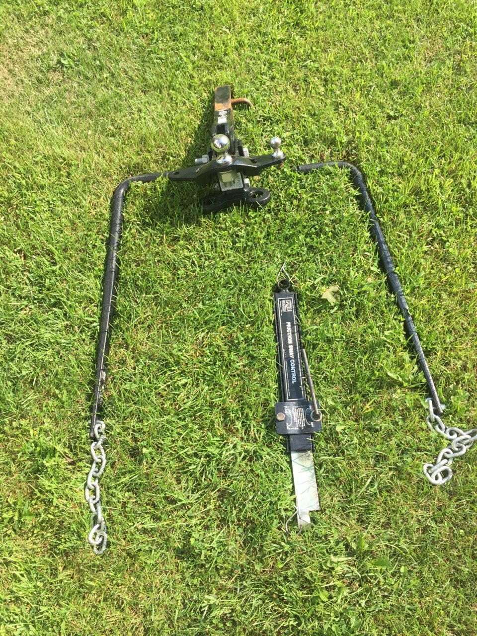

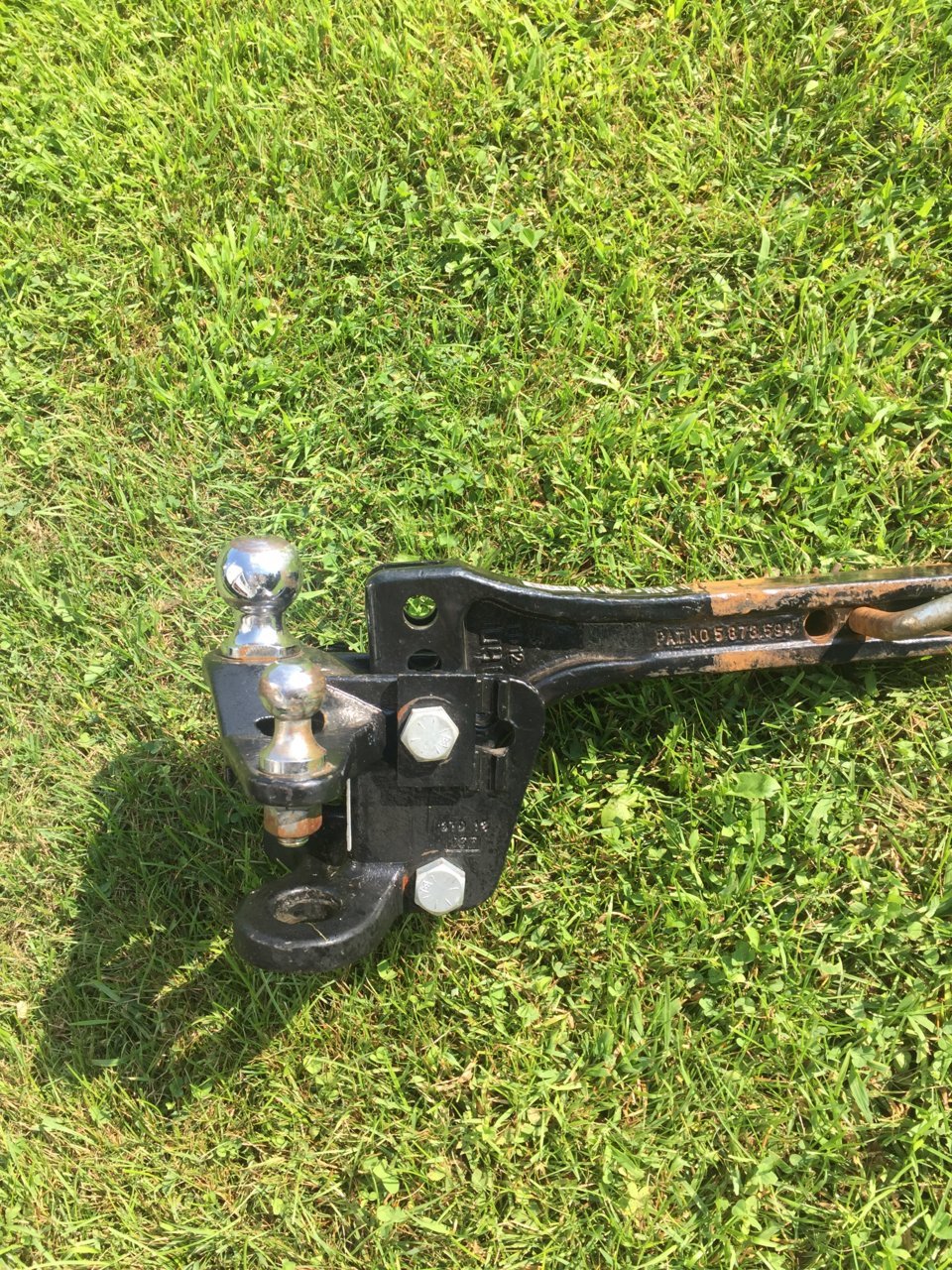

    I will take a picture of my hitch , give me a few minutes :thumbsup:
  18. Aug 5, 2018 at 6:47 AM
    #38
    lynyrd3
    Apr 9, 2008
    #5848
    35,533
    Bill
    East Central Upstate NY
    WD hitch with anti sway bar . Probably around $500 74DA1A4F-3338-41CF-B2C1-F4EE37A40709.jpg 82E6D5E7-17C5-4242-AE66-3C69DF16E7EE.jpg 1C8F0B7D-CFF9-4C94-9C9F-00BDE00224C9.jpg

    Also: added a pic (not mine) to post 23 above. It is a 2nd gen, stock location, but the grill is not in the vehicle so you have a nicer view. Now you know what you are looking for.
