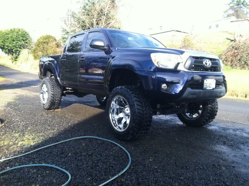

    New Leaf Springs Added and Installed.
    Here are two pictures
    8" of Lift up front
    9 in the back

    I see that you can still fit in the carport. Would you mind telling me how high the rafters are so i know how much clearance ill need when i tear down and rebuild my carport. my stock barely fits in there now?
    thanx
  8. Feb 3, 2012 at 11:07 AM
    #88
    Wizzard005
    Wizzard005 [OP] Well-Known Member
    Aug 27, 2011
    #62412
    778
    Greg
    Sacramento, CA
    Stock
    I don't know high the carport is, but the truck is about 7 1/2 Feet tall... I hope this helps...

    curious as to how you managed to get 9" in the back. i know you have the 6" alcans +300. 2-3" block? i would also assume that you have a top plate spacer on top of the dirt logic coilovers?
  11. Feb 6, 2012 at 1:13 AM
    #91
    Wizzard005
    Aug 27, 2011
    #62412
    778
    Greg
    Sacramento, CA
    Stock
    Well starting with the back,
    Fabtech gives the following:
    3" Block, and 1 1/2 add-a-leaf , however they figure it, it gives the back 6" of lift
    Well I ordered 6" springs so ditching the blocks and their add-a-leafs gives a true 6" of lift not 4 1/2 to whatever stock already was.
    The front are adjustable, so i raised it 2" witch looks still almost stock, (the CV Arch)
    The rear dirt logic shocks are still longer then what i have, they dont bottom out, so no there are no spacers on them....
