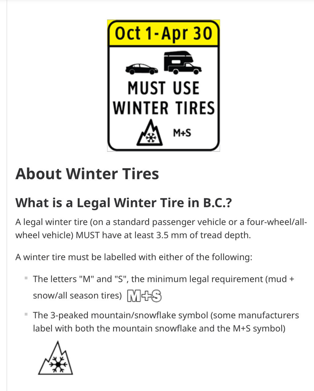

    Supposedly true but I've heard many times that you will get fined if you don't have the Severe Weather Rating (3 peak snowflake) if you're traveling highways in BC.
  15. Oct 13, 2019 at 10:46 AM
    #55
    Stocklocker

    That is not true. M+S is all that is legally required.

    All I'm saying is people are still getting fined across the province for mountain pass highway travel without the snowflake. I'm aware of the legalities of it, I live in BC.

    If they are getting fined the police are wrong and they should not pay. I wouldn’t. I also live in BC and know of no one incorrectly fined.
    50% of cops are below average. I’m sure some don’t know the laws they enforce. That’s why we are allowed to challenge a ticket.
