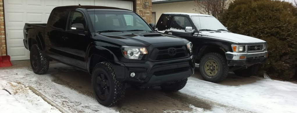

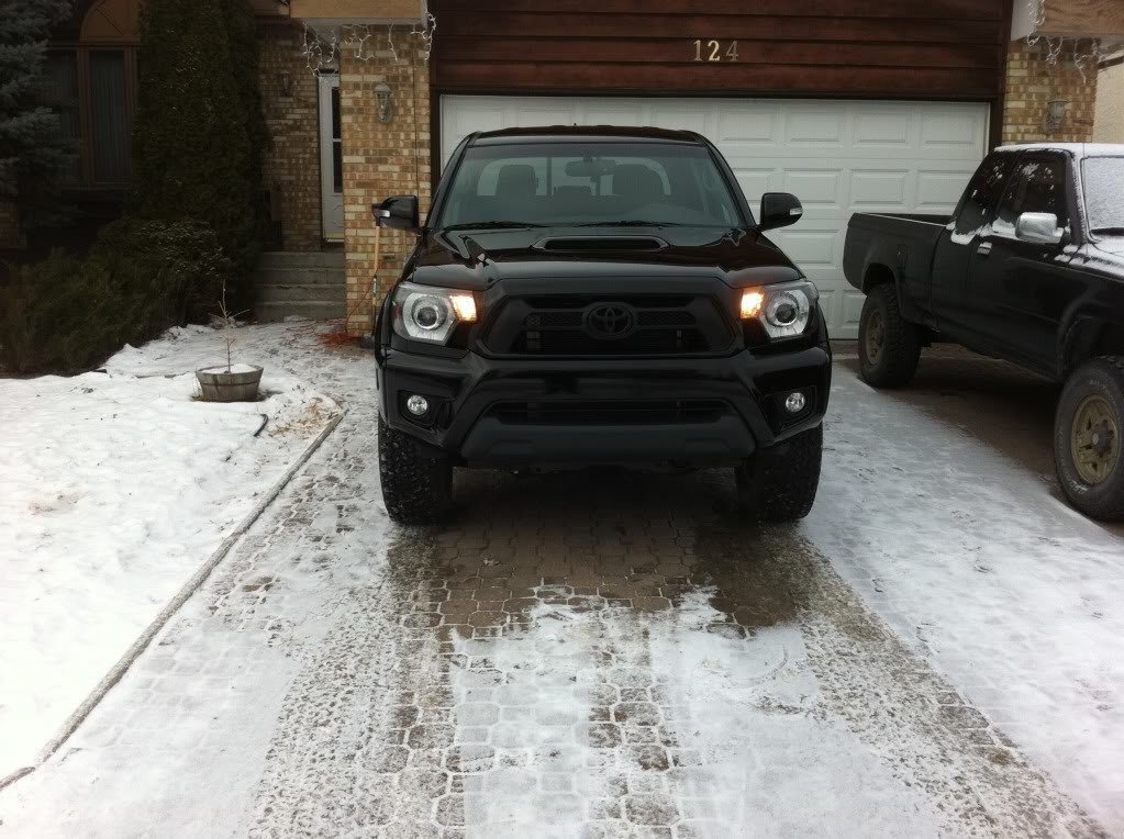

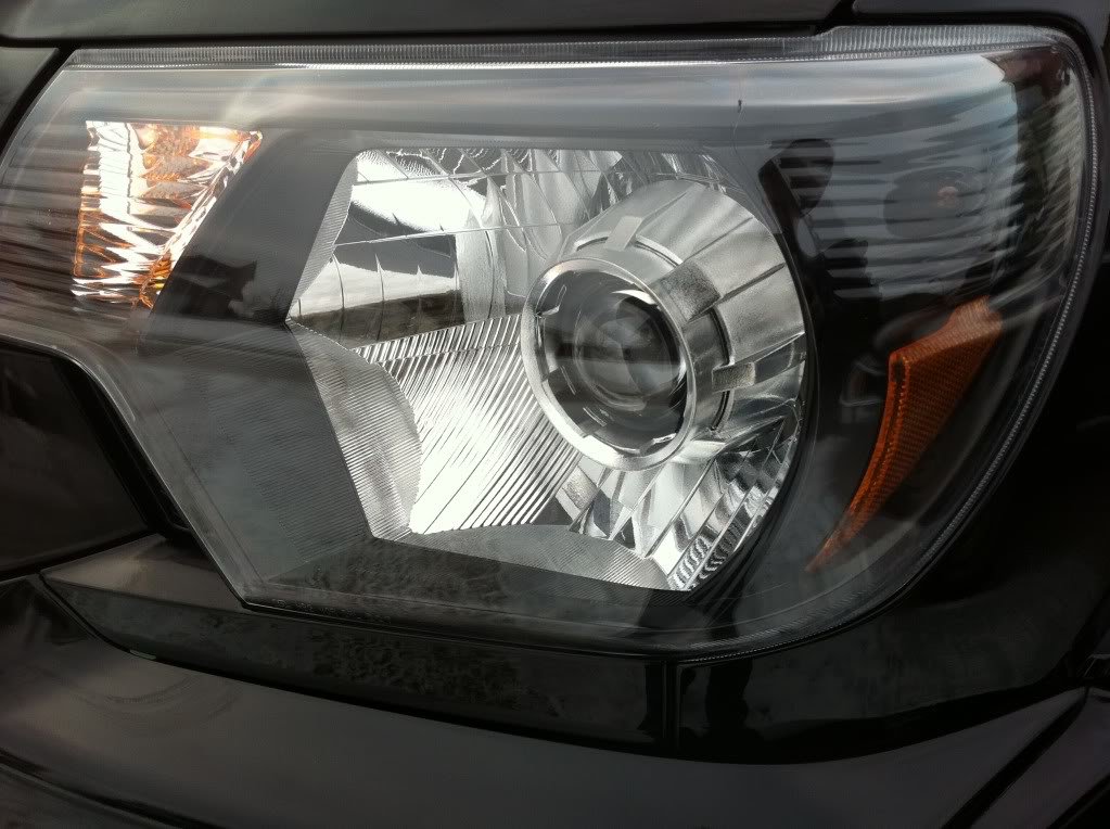

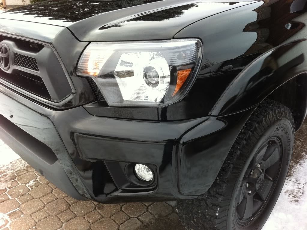

    Just finished installing my Bi-xenon Morimoto Mini Stage III Kit (D2S) from the last group buy...in all honesty if I could do it again I would go with the FXR's...the Mini kit has been more of a pain to get lined up then the FXR's would be in my opinion and probably has more light output.

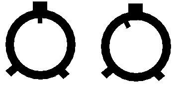

    For anyone getting the Mini's do not expect the alignment to be perfect...the alignment is about 15' off and will require cutting...and if I'm cutting a little I may as well have cut alot. Not very happy...it looks good on the outside but I wanted a quick install not having to fool around.
    Here's a pic of the install though...looks good with the BHLM on the 2012's and gatling shrouds!

    I haven't cut anything yet...I may be able to make a different adapter plate to fix the alignment issue...here's the idea:
    On the left is what it came with...the one on the right is what it should be to get a completely horizontal alignment with no tilt.

    From your pics, I could see the driver's side being a little off. Could it be that the D2S' were more difficult to align b/c the newer lights are more concave compared to the older lights?
    Or are the FXR lights shorter than the D2S? Can you be more specific, this is all new to me.

    The way the Mini's work is there is supposed to be no cutting just basically a plug and play and only one way to horizontally align the projector as there is an adapter plate with a notch that aligns the projector when you tighten the nuts on the back.
    Check out an install here for a better idea: http://www.theretrofitsource.com/pdf/trs_tech/Morimoto_Mini_D2S_Retrofit.pdf
    Here's a picture of my crapoff for a reference...this is how it is now until I have time to fix it...100% worse than OEM light output.

    Holy F:eek:ck!!! Your bulbs might not be on right...
  19. Dec 23, 2011 at 12:15 AM
    #79
    Commanderwiggin
    Commanderwiggin Well-Known Member
    Nov 21, 2011
    #67438
    356
    Calgary
    12 Tacoma D/C 4x4 TRD Sport 6MT Supercharged
    Only one way to go on...I'm the 3rd person with this issue that I know of on the 2012's...not sure if it makes a difference or if it's just a bad batch of adapter plates. Not happy either way.
