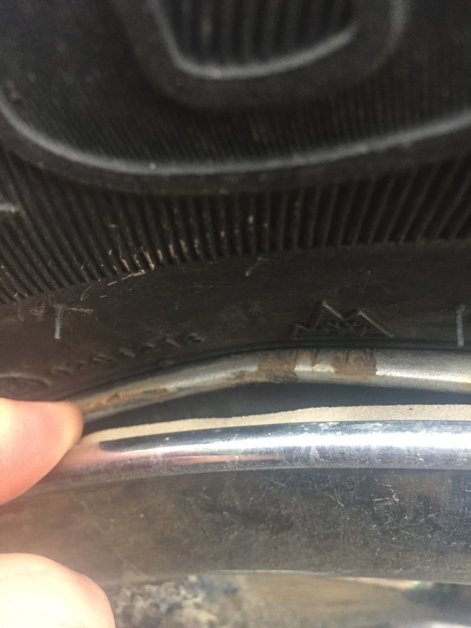

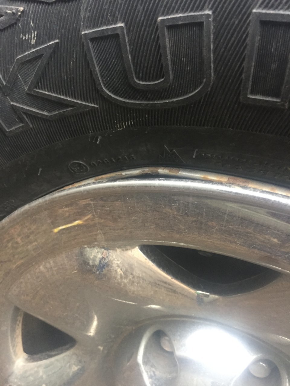

    recently got my tires rotated and am now noticing a significant wobble/shake in the steering wheel and cab at speeds above 60mph. I looked at the wheels and noticed one had a good dent in it, there is rust in the spot so I don’t think it was the recent tire rotation that caused this. Just wondering if this dent (driver side rear) is enough to cause a wobble or if I need to check out other things. Thanks!

  2. Apr 3, 2018 at 5:22 PM
    ChadsPride
    Nov 26, 2014
    #143119
    127,315
    Sponsored by TacomaWorld.com
    Oh yeah, that'll cause a shimmy.

    If it were on the front maybe not so noticeable? I really never noticed it before my last tire rotation?

    In either event I would replace that wheel ASAP.

    you have a few options, either send it out to a rim shop to fix it, or just buy a new from the junkyard. you can also just keep that bent rim in the back and you wont get a shaking in the steering wheel

    Bent one is on the back now. Driver side rear.

    If it's in the steering wheel, it's not the wheel on the back.
    Have your tires balanced.

    Looks like I am missing a couple weights, I pulled off those stupid chrome wheel covers and noticed what looked like one missing from two different wheels. I’ll take it to the tire shop and report back, thanks!
