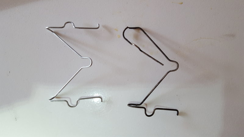

    So,
    Finally got around to replacing the brakes again. Found a broken pad return spring. $3 part that I think was cause for abnormal wear and the wobbling. So, threw new rotors, pads and springs in. Cleaned and lubed the pad retainer pins and back/side of pads. Did some breaking in of the brakes, so we'll see how these hold up! Was also interesting to note that the old pads (the ones with ~12K miles on them) appeared excessively worn, like 1/8" less material compared to the new pads. So, maybe they've been rubbing the entire time, which in turn probably killed my fuel economy as well.
    Oh, and the wobble is gone.
