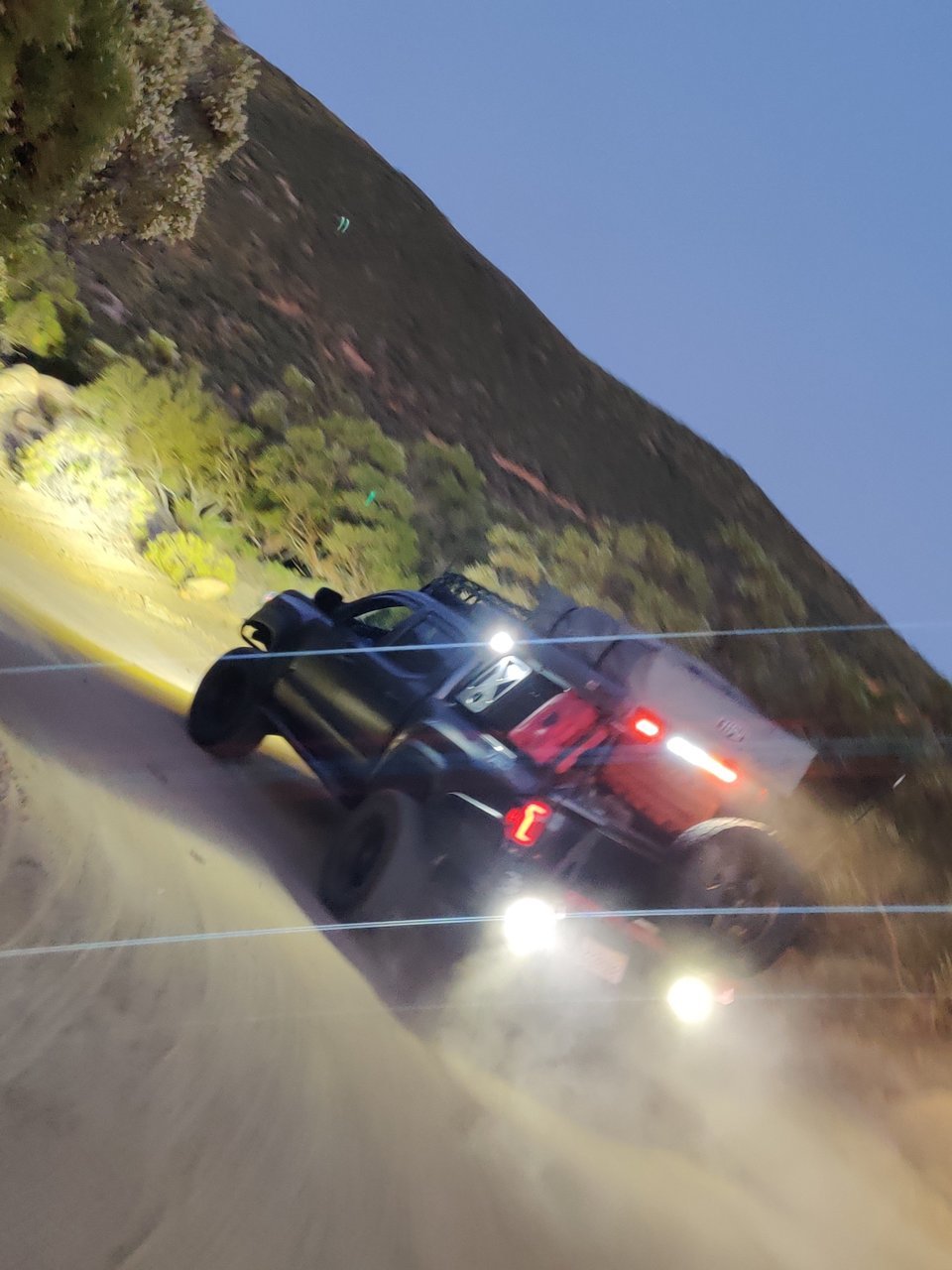

    Also here's a pic from the run for your entertainment:
