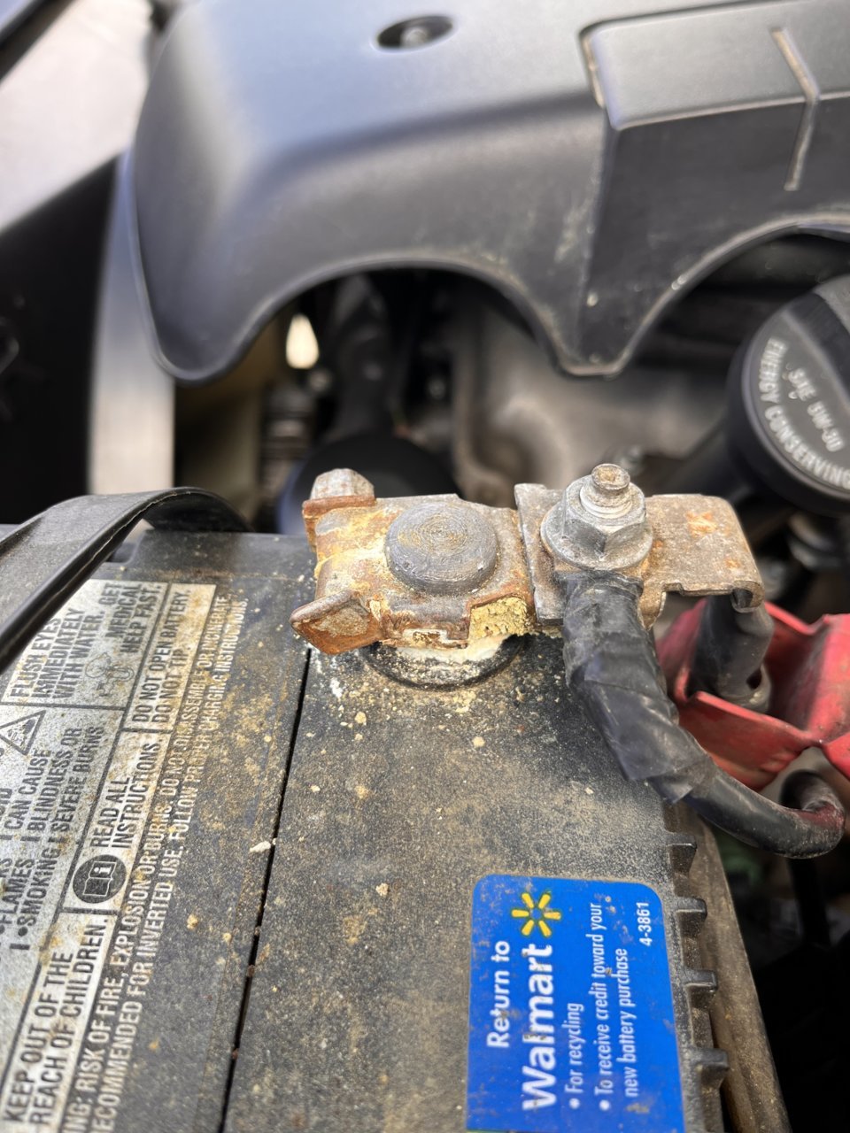

    I recently removed some ditch light brackets and wiring, the brackets I had required cutting the rain tray some to fit. After doing this, I took some time to clean the underside of the hood with simple green/water solution, noticed that the water runoff dripped onto the tray. Proceeded to use water/rag to clean the engine cover, fuse box and other black plastics...making sure not to drench the parts, but to use a wet rag/some water. This morning my truck would not start. No electronics nothing....jumped the battery and it started immediately. Let the truck run for about 10 minutes. Turned it off and let it sit for about two hours so far and starts with no issue. Battery is a few years old but I've seen no sign of a bad battery up until this morning. Could I have gotten water somewhere it shouldn't have been in and it caused the truck to die overnight?

    I did remove an aux fuse box at the same time, noticed a lot of corrosion around the + terminal. Could the corrosion have an impact all of a sudden? I'll go back and make sure all those connections are tight again. But its weird that the car started within seconds with a pair of jumper cables..I've always seen cars struggle when starting while getting jumped.

    So battery checked out fine, 100% charged etc. Starter tested and no issues present.
    I bought a terminal cleaner, but the terminal itself is really stuck on there. Is there a safe way to clean this without taking the terminal off?

    Loosen the nut on the terminal, work it back and forth and up and down. Get that off there and clean both terminals on the battery, as stated above, watch your battery closely when starting to notice it craping out.

    Definitely tried working it...its pretty stuck. Can I safely spray something on there to loosen it up a bit?

    That terminal looks like shit run over twice. Spray some fluid film on them to keep them fresh after you clean all the crusty stuff off.

    Replace the terminal and wire wheel the 2 cable ends.
    Cleaning that is a temp solution.
    Once that is all done along with cleaning the neg terminal, have battery tested and check for a draw.

    you need to replace the terminals once you get it removed. Pour some coke on there, loosen that nut and pry apart the gap where that bolt is with a flat head screwdriver. It should loosen enough to hand twist it off. Too rusted to try saving. Just go with new terminals to prevent future headaches.

    I'd completely remove the bolt and use a flathead or a pair battery terminal spreaders to loosen and remove the terminals.
