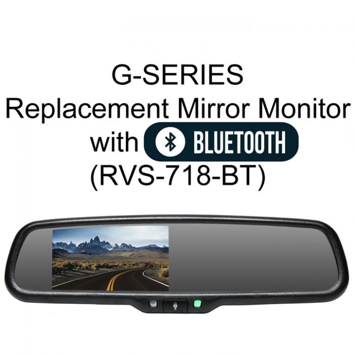

    Instead of the OEM backup camera showing up on the head unit, it displays on the rearview mirror, so there must be some kind of hookup to see the factory backup camera.

    On my 2013. This isn't the exact mirror but here's an example...

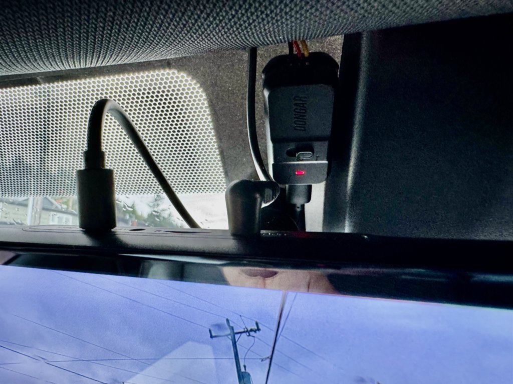

    My G900PRO arrived yesterday, and I mounted it to the factory mirror mount using the Wolfbox plastic mount. It feels strong enough to me. I know some people prefer metal mounts, but I don’t think they are necessary. I used the Dongar Pro adapter, which works perfectly on my 2020 with the Homelink mirror.
    I removed the cabin light/sunglass panel, tucked everything neatly inside, and mounted the GPS antenna to the metal roof. I might look for a shorter USB-C cable with a 90-degree bend for a cleaner setup, but it works fine for now. The most frustrating part was peeling the backing off the 3M tape on the Dongar Pro. I had to use needle-nose pliers to get it done. For now, I’ve mounted it to the windshield, but if the battery life is good enough for 24-hour mode, I’d like to move it into the headliner later.
    For the rear camera, I’m still deciding where to mount it. The license plate would be the cleanest option, but it’s probably too low. Most likely, I’ll mount it under my RTT, but that might not look great with the wiring and could be a hassle when I remove the tent. I’ll experiment and see what works best.
