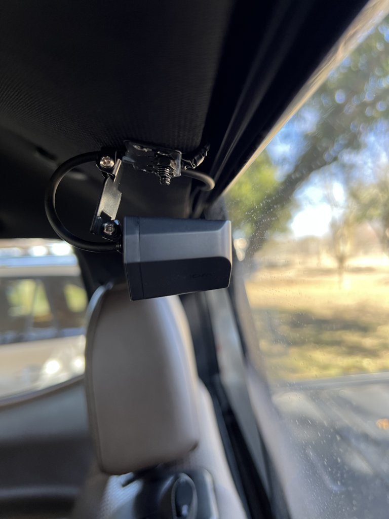

    Can you share/explain a little more about how you mounted the rear camera? Did you bolt it through the headliner?

    I used a license plate holder and shoved that in the headliner.

    Dang, that's a really good idea

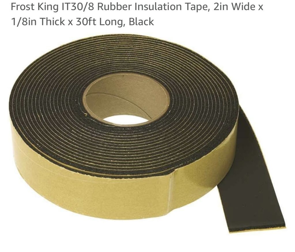

    If you do it add foam tape to both sides so it doesn’t shift and to keep it from scratching the roof.

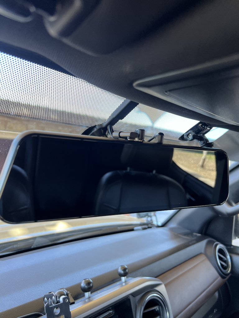

    I have the direct mounted version. If you pull the visor down it will touch the mirror by about an inch. You can however maneuver the visor around the mirror to touch the windshield. Kinda annoying, if the mirror was a little smaller it would be perfect.
