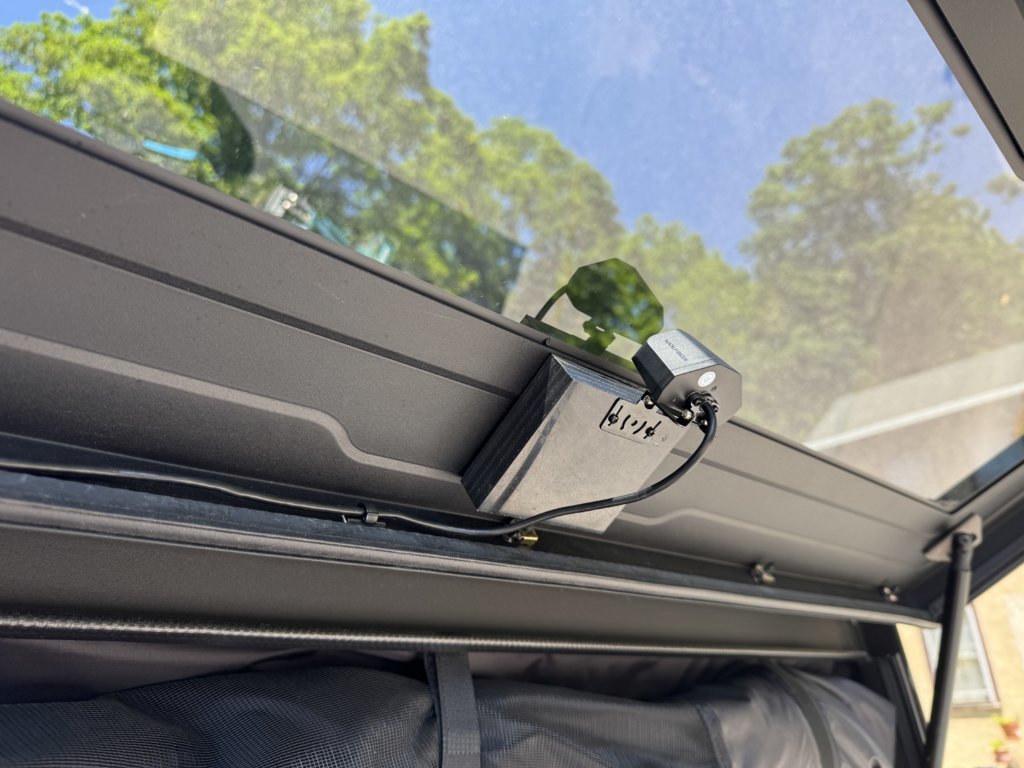

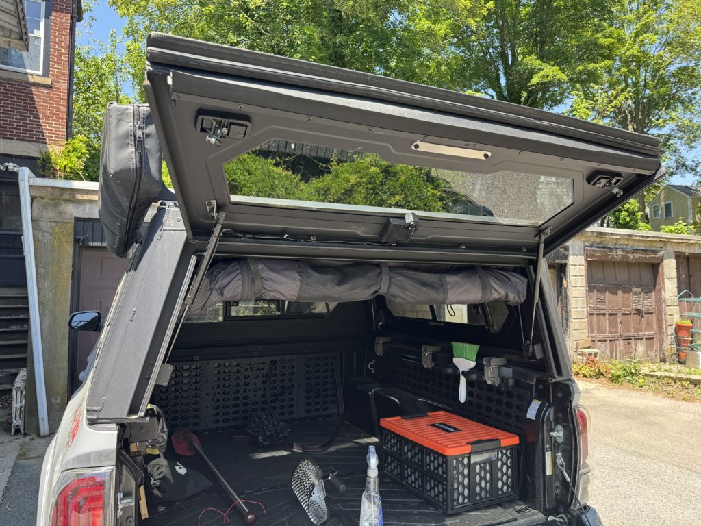

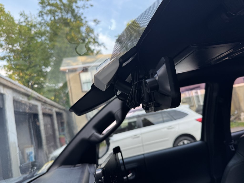

    I know I'm a little late to the game in posting one of these, but I wanted to share my mounting setup, incase anyone else was still in the market for a rear camera that also had a rear canopy/camper setup.
    I ended up finding a piece of HDPE on Amazon, used some black Permtex silicone adhesive, and mounted the block to my rear hatch. this makes my rear visibility absolutely unobstructed. The only downside is the length of the cable that comes with the G900pro kit. They make a 33' cable you can buy, but all i did was buy a USB-C Female to male 15' cord which helped me extend the camera cable into the cab. Works great!.

    Rear view mirror screen is a nice touch...miss that about thr 3rd gen vs 2'nd (at least the 2012 prerunner).
