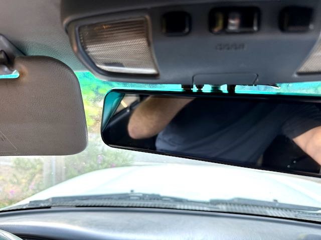

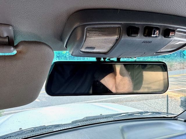

    I installed and tested out the Wolfbox mount that @biggestchungus created and sent me (thank you!). I have a Wolfbox 930 and a 1996 Taco with a mirror/dome light assembly I transplanted from an older 4Runner a while back. Bravo @biggestchungus! It's really nice. A few thoughts:
    POSITIVES:
    Looks great, easy install, fits my WB 930 perfectly, but best of all, *my visors clear the display*! See the pictures below. Also, because of my almost-60 year old eyesight, a side benefit is that the extra distance from my eyes to the display helps me see it more clearly :)
    ISSUES (or potential issue):
    The pivot / ball needed epoxy or superglue to keep it from moving. This is no big deal, but eventually, I will wack the display as I inevitably do to my rear view mirrors in the course of things. I wonder what will happen. Will it break the mount or...? I wish there was another way to tighten that ball joint.
    Note: this mount is *only for the 930 model*. It won't fit others as far as I know.

    looks great! Go ahead and break it. Ill fix the weak spot and send you another. Not sure what to do about the ball joint maybe I can make room for a lockable one like this.[​IMG]

    just confirming that the visors clear the 10” models? I just measured the space between my two visors along the plane where the current mirror sits and it’s 9 3/8” clearance between the two.

    I can confirm that with this mount, my Wolfbox 930 with its 10" display will clear the visors.

    yeah. you have to angle it slightly, but it does just clear.
