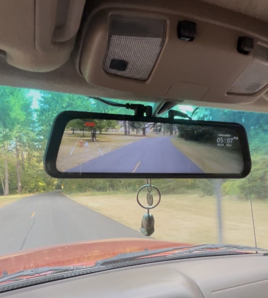

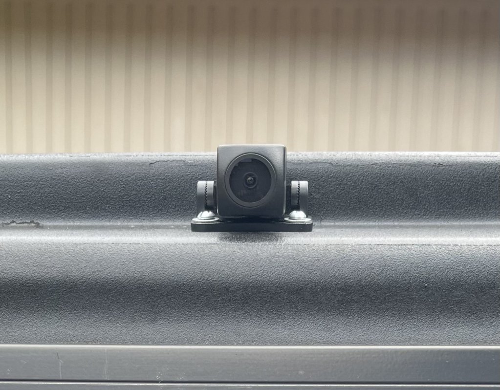

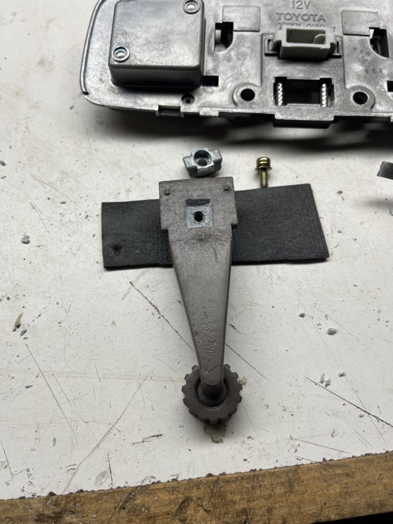

    I finally installed my wolfbox G930 using biggestchungas's mount and I've been using it for about a week. Here is my experience with it. The installation was easy. I mounted the rear camera on top of my canopy and ran the cable into the cab. I had to order a longer 33' cable because the cable that came with the wolfbox was a couple feet too short. I want to be able to remove my canopy without taking everything apart, so I routed the cable thru the canopy roof, into the backside of the left taillight, under the bed, up thru the floor grommet, and under the carpet to the A pillar. The cable can be separated a couple feet from the camera. I also wrapped the cable under the truck in spilt wire tubing and secured it with zip ties. The wolfbox display attached perfectly to the biggestchungas's bracket. I had a small issue attaching the arm to the roof mount. The problem was with the square notch in the arm that I had painted over. I had to scrape off the paint inside the notch because the square nut was not seating fully.IMG_1887.jpg IMG_1886.jpg IMG_1887.jpg
    The positives: The best thing about the wolfbox is the clear wide-angle view when driving in the daytime. I think mounting the rear camera up high is the best place to put it. No more peering down a tunnel thru two layers of tinted glass! That's the main reason I wanted to try a wolfbox and why I'm fairly happy with my purchase. The unit doesn't interfere too badly with my visors but I run it with the front camera not extended because it's tight and I don't want to make it any tighter. The less fiddling you do with the angle of the display the better. Plus, the front camera swivels allowing you to compensate somewhat for having the unit angled towards you.

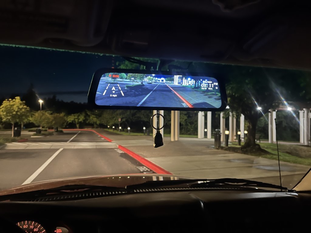

    The negatives: Number one is the brightness of the display when driving at night. I have it dimmed all the way, and I still thinks its a bit too bright for night driving. I wouldn't recommend mounting the camera at bumper level because car headlights would probably just fill the display with white glare. The white light is still a problem for me but I have pretty sensitive eyes. Lately, when driving at night I have started scrolling the display down so that I don't see glare until the car behind me is very close. I realize that doing that limits my ability to see what's behind me. Number two is that the wolfbox shacks a lot and I mean with normal on road driving. I haven't tried it off road but I would think that the shacking would render the unit worthless. From what I can tell its not because you can't screw the ball joint down tight enough. I have the everything cranked down securely so wolfbox won't shift unless you knock it by hand. The arm is also solidly connected to the roof. In one of my pics you can see a small piece of foam I stuffed above the arm and the roof in an attempt to reduce the shaking. It didn't do squat. I tried to simulate the shaking in this video https://youtube.com/shorts/X6HF8O_ssXk?feature=shared. Possibly, the arm or the mounting bracket (or both) need to be a little beefier. @biggestchungas, If you want to try making a beefier version I'd be very happy to test it out for you.

    To be honest, the locking ball is kind of a pain. If you knock the display or adjust the angle you have to crank it down again which is kinda annoying. I also found that because it's a display and not a reflection, the angle that its at isn't that important for viewing. I played around with which angle was best for minimizing visor contact and noticed that you could view the display pretty well in most positions, including not angled towards the driver, or pointed straight back.
